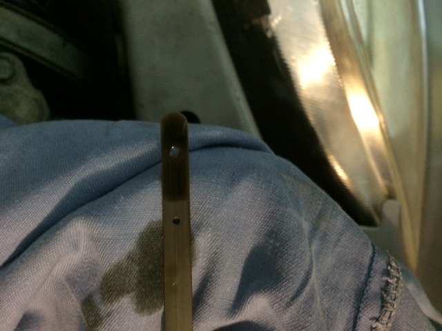

Well, I will update everyone with the oil consumption issue... Filled the car up this morning at 391.9 miles after the oil change with Valvoline max life 5w30 and the CD2 oil additive. The fluid/oil level was just over the top hole on the dipstick after the oil change Sunday, and here is a pic of the oil level this morning just before leaving for the fuel fill up when the motor has sat in the garage all night. Oil seems to be pretty dark already as it was clear Sunday when I changed it. Car used 11.088 gallons and got 35.3 mpg's and before the oil change was getting 34.3mpg's.
SO the questions is, do I just leave it be and keep adding oil since it seems the additive helped slow down the consumption(which I am fine with for now) OR go ahead and sea foam the motor and possibly risk cleaning it out to much and making the ring problem worse since I don't know exactly what it is?
If I just leave it alone for now, should I add another qt of that CD2 additive with the next oil change or anymore to the current oil?
Thanks for everyone's help btw!
wow, my oil looks cleaner then that when its due to be changed after 4-5,000 miles

Ya what came out when I changed the oil the too was black, and we were putting in what seemed to be 2qts a week. The oil shown has the additive in it as well, but it was also clear for the most part. Maybe it has something to do with the fact that it had fully synthetic in it before which cleans everything. ??
Old Oct 17, 2014

Wow, something made a difference!
I would keep it topped up with 5w-20 and keep track of how much oil it uses for 3k miles. If you go through enough oil I'd add some CD2 additive in too. Try to keep the ratio of additive the same.
The picture was to show the level and its hard to tell, but it does look dirty for 400 miles of driving.
I agree with Mikey, frequency is more important. I use Pennziol or Castrol from Walmart. Whatever is lower price. Quaker Sludge is okay too. I let the Mercedes jocks keep Mobil 1 in business.
I also try to use top tier gasolines. http://www.toptiergas.com/
I have the first CD2 treatment in right now with this oil change. So far it's gone through just over half a qt in 400 miles but it's better than it was two weeks ago. I have valvoline 5w30 max life (synthetic blend) in it right now with the CD2.
