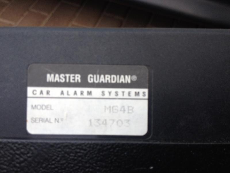

It would seem your security system is unlike a factory or dealer installed Honda accessory security system here in the US.
Yours uses a separate siren, ours use the vehicles horn.
I'm going to suggest you try to obtain diagrams and instructions for that brand of alarm (google the company and model numbers), or visit the original dealer that had it installed.
Seems like it could be interfering with the operation of the OE keyless entry.
I have no way of knowing for certain.

Thanks a lot for the installation instructions, but unfortunately I could not located the receiver. Perhaps, it varies from model to model ( mine is 2004 M.Y, 4 doors, not sure for an exact model).
What I did found is a blown fuse located close to the under-dash fuse box. This fuse is 10A wide fuse, unlike the others, smaller fuses both from under-hood and under-dash fuse boxes, sitting in some black fuse-house box. I'm not sure this fuse is somehow related to my problem, especially due to the fact, that the system perfectly works using the door power locks, but I'll give it a try once I found this fuse.
