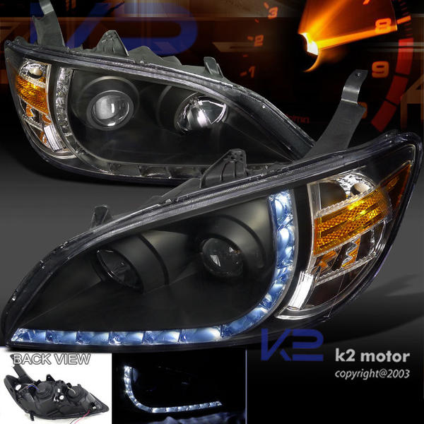

Headlights... I am going for style here so I was looking at matte black projectors.. My fave that I have seen online are the R8 style replacement assemblies.
I don't know if these are HID compatible or not... also... not sure if I want to go HID.

Best option for light is to do what is called a retrofit. Those lights that you posted a pic of will leak and supply poor light output. Retrofitting is a way to put HID projectors into your stock headlights.
HID... problems, best, affordable, worth it?
HIDs on their own aren't so great. You trade a little more visibility for a lot more glare (for yourself and other drivers). HID projectors, on the other hand, are great! Not only do they focus the HID beam to where you need it, but they also allow for a nice cutoff so that you don't blind anyone else coming at you.
Aftermarket headlight assemblies are generally considered to have inferior reliability to the OEM ones, so a lot of us choose to retrofit instead. This means we put HID projectors into our OEM housings. TheRetrofitSource is probably the gold standard, and this kit is their most popular. The have a pretty good warranty on all their parts, too. Not cheap, but soooooooooooooo worth it and not too hard to install if you have the tools.
