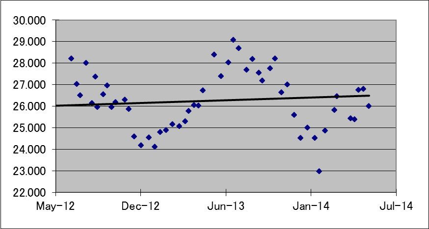

winter impact, yes.
this is my 95 miata MPG... clearly the winters are no good for it.

Another factor in that graph however, is that in order to keep fuel mixture close to stoichiometric, the MAF FI system in the NB's BP motor will add fuel to the mixture to compensate for higher air density due to low temps. So really it wouldn't matter if the ethanol content changed or not... you'd still use more fuel to drive around, esp if the temps dip into the 50 degF range or below.

Oh forgot to add... the median trend for that graph shows gentle, consistent dips and rises into worse and better fuel economy. Since summer and winter fuel blends aren't added gradually but rather abruptly switch over... the change is again more likely to be from ambient temps due to seasonal variation, than ethanol.

although i step less on gas pedal in the winters, so i guess it could be much worse

Yup. Gotta remember too that even if the coolant warms quickly on the gauge due to a good thermostat and healthy cooling system... your oil, trans fluid, bearings and seals will still have extra viscosity and shrunken sizes, until they warm. All of that is add'l load compared to summer...
My uncle (who owned and serviced all of the eight cars in his family, including four CVCC Civics *shudder*) said that he taught my cousins to make their cars last by driving <25 mph in the first five mins of driving, esp in winter. Heard this repeated decades later with NPR's Car Talk (Tom & Ray Magliozzi, 'Click' and 'Clack'. Makes sense to me.
