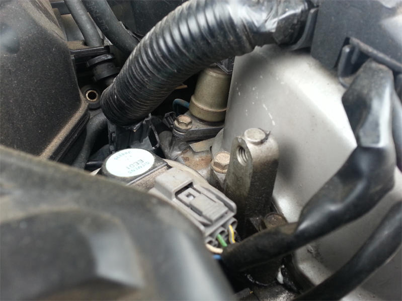

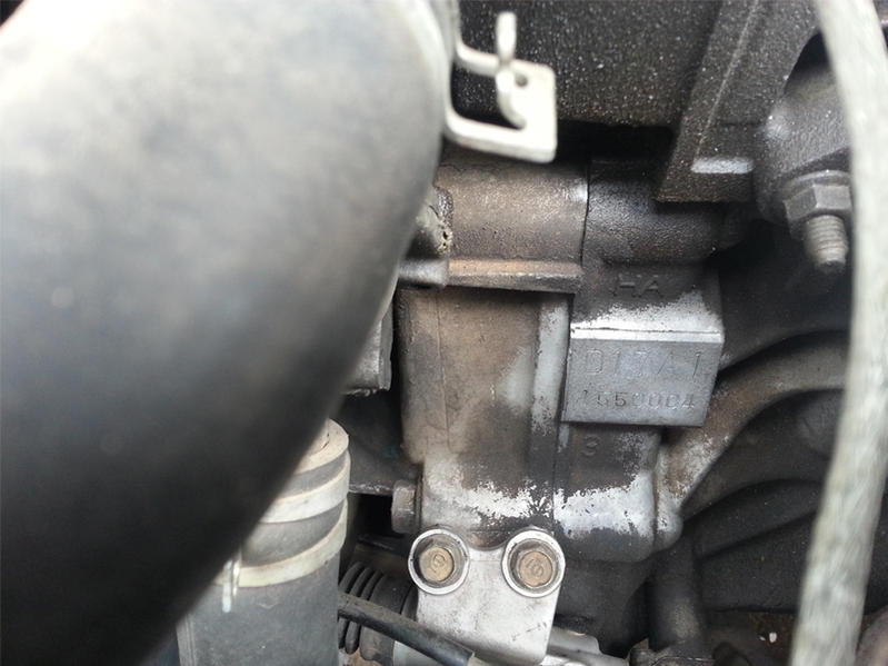

Here is some pictures of headers, VTEC solenoid, and the block

I see a bolt missing from the breather mount, and the grommet for the hose is out of place.
Otherwise, I still say it must be that someone replaced the short block with whatever was handy/cheap.
