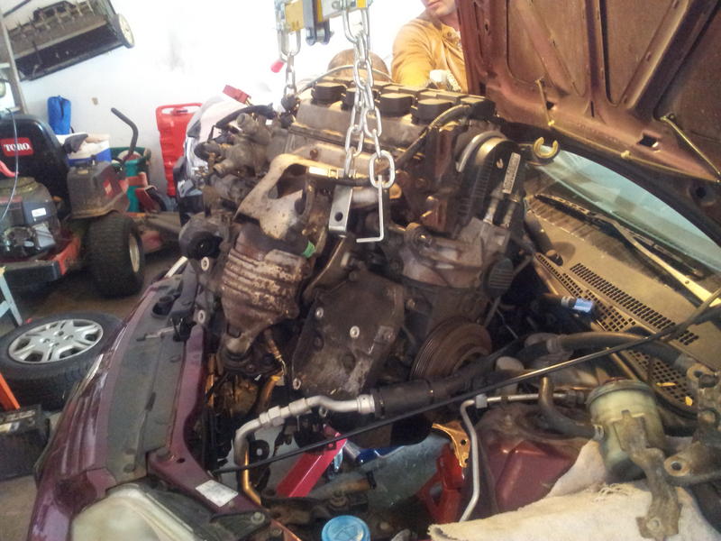

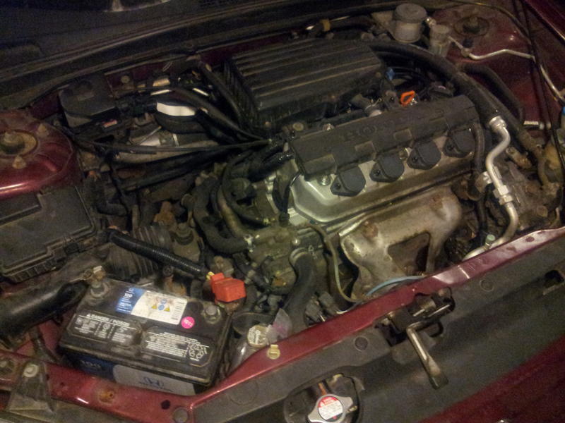

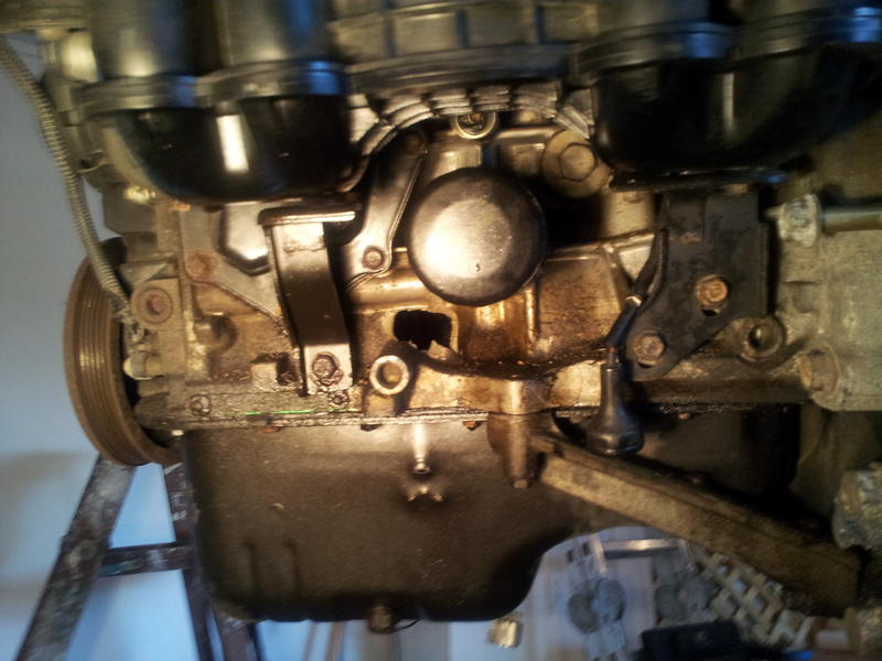

A few quick pics...
ID:	85798   Click image for larger version
ID:	85799   Click image for larger version

Ouch.
We might refer to that as a "porous casting", "positive crankcase ventilation" or maybe "hatched" if the rod came out.
