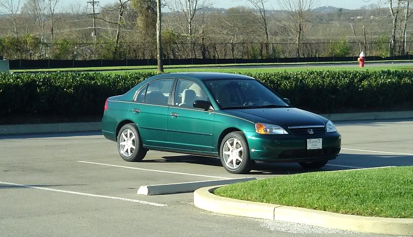

no suspension adjustments needed, unless you buy wrong wheels, like said above (offset is crucial to not to have the tires rub on fenders.
of course, it will look like a 4x4 without a mild lowering...
see below what a mere 16" will do...
