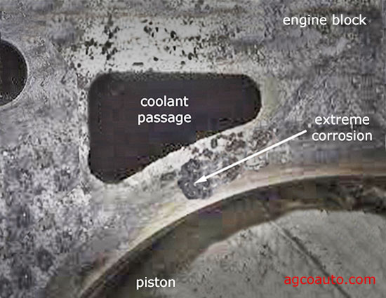

First time post...
I just bought a 05 Civic Sedan and was looking at the DIYs for timing belt changes. I then noticed people were changing out head gaskets at the same time. After a little searching, I came across this thread. I am a little worried as my car had 93,000 miles on it when I bought it. I am not running out to change my head gasket just yet though.
Anyway, I know I am bumping a month old thread but here goes my theory...I have an extensive background in aviation maintenance and one issue aircraft have is corrosion. While there are many types, galvanic comes to mind. Galvanic corrosion happens when there is two dissimilar metals in contact with each other and there is an electrolyte added. (See Wiki: http://en.wikipedia.org/wiki/Galvanic_corrosion) For example, in an aircraft, if there is an aluminum part with a different titanium part riveted, or connected together somehow, and that aircraft flies through a rainstorm, those parts will start to corrode if they get wet and are not properly protected. Yes, this happens...
Thanks if you are still with me reading this!! As we know, our engines have aluminum heads and MLS head gaskets. Okay, two dissimilar metals. But wait, Honda spec antifreeze is used and isn't corrosive (not an electrolyte...) so how can galvanic corrosion happen?? Well, when that car was taken in for service, did some tech add tap water at some point to top off the coolant? Did a previous owner add tap water when they accidentally popped a cap off of a hot radiator? Whatever the scenario, it could happen. Tap water is a mild electrolyte. It contains trace minerals which can conduct electricity and therefore allow the two dissimilar metals to corrode. Distilled water doesn't conduct electricity and therefore not considered an electrolyte.
Here is a pic of a corroded head gasket:
Pic used from this website:http://www.agcoauto.com/content/news/p2_articleid/200
Okay, it is a long shot, but corrosion could be the explanation for the failing head gaskets. I am not saying everyone should go change their coolant right this second, but just opening this thread up to a little more discussion...
Is there any close up pictures of any failed gaskets? I know its a long shot, but worth a look to see if there are any signs of corrosion.

I just tossed out the one I did last Friday morning. IMO you can't ever tell for certain (visually) exactly where the breach was unless it was just a huge leak.
These can breach regardless of coolant history. We have plenty that ran with the factory fill, then type2 premixed coolant, so no tap water ever added.
I think it has to do with thermal cycling, the aluminum head expansion is limited upward by the head bolts, so it must compress the head gasket. The repeated cycling eventually causes the gasket to fail.
I think if the head bolts in this engine were TTY, they would retain a more constant tension on the gasket under a much wider range of operating conditions, or for a longer length of time/cycles.
TTY head bolts worked very well on other engines with MLS head gaskets.
JMHO, YMMV.

Nope, not the main problem. There may be some that blew sooner than they should have because they used water and it corroded the head, but not the ultimate problem. I bought my 02 civic ex brand new with 33 miles on it and it had nothing but the green original coolant followed by the current blue coolant that got changed when I did my timing belt. It was taken care of very meticulously by me from when I bought until now and it has a little over 93K on it.
Here's my thread when mine blew with pictures. You'll see both my head and block have no corrosion to speak of whatsoever.
https://www.civicforums.com/forums/3...ml#post4621035
