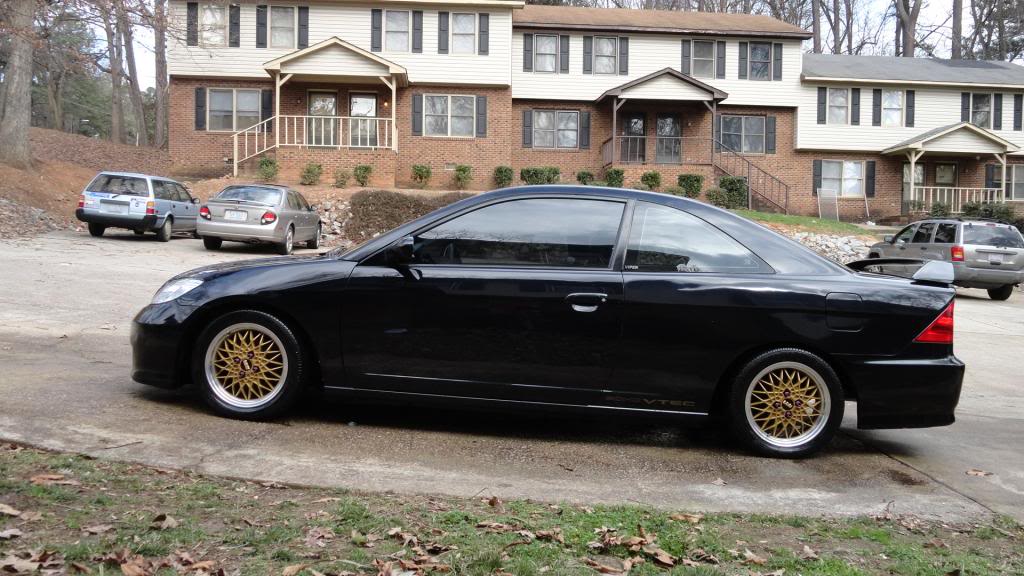

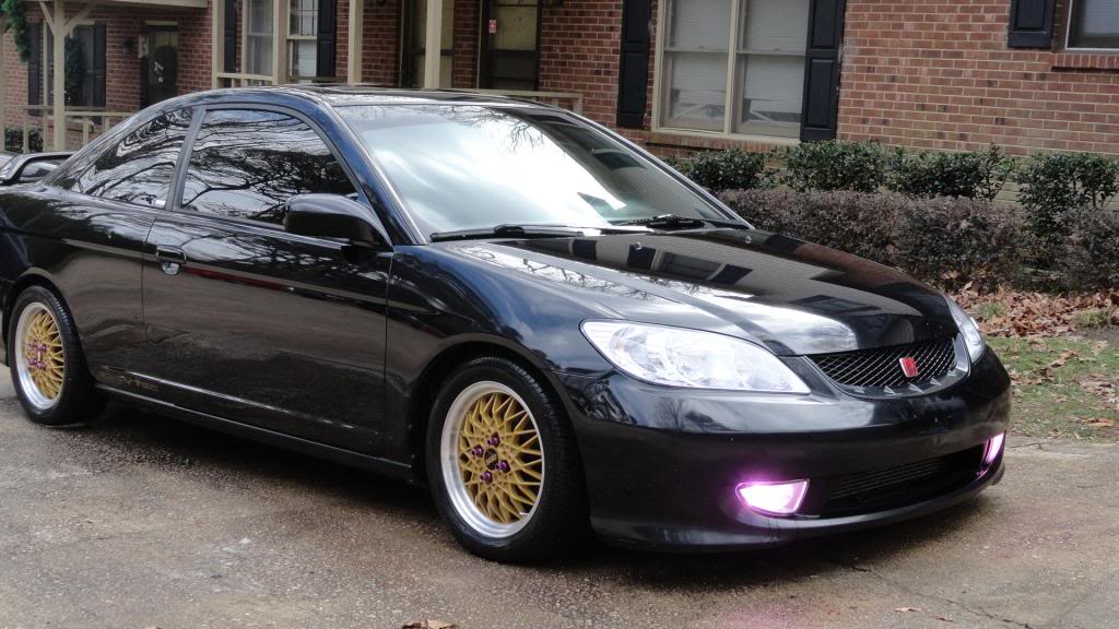

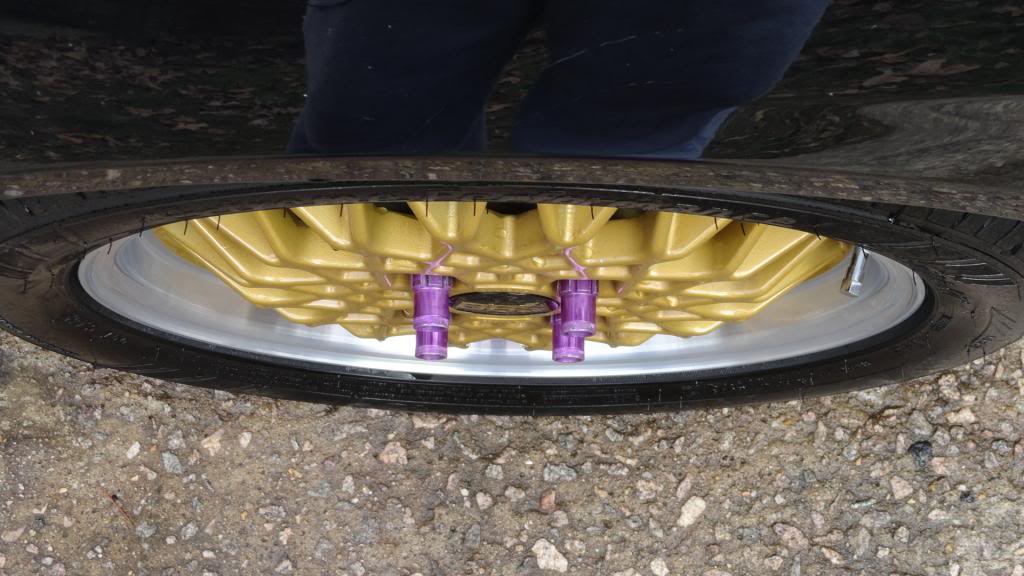

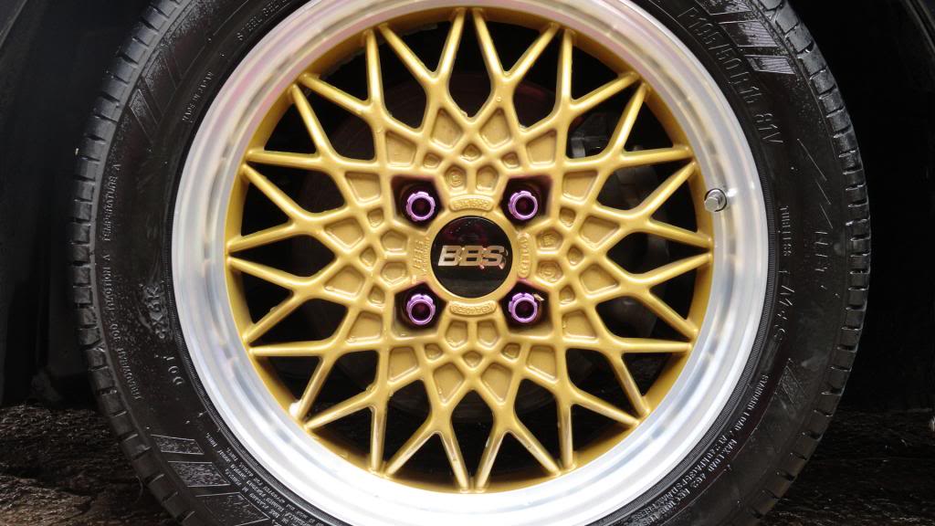

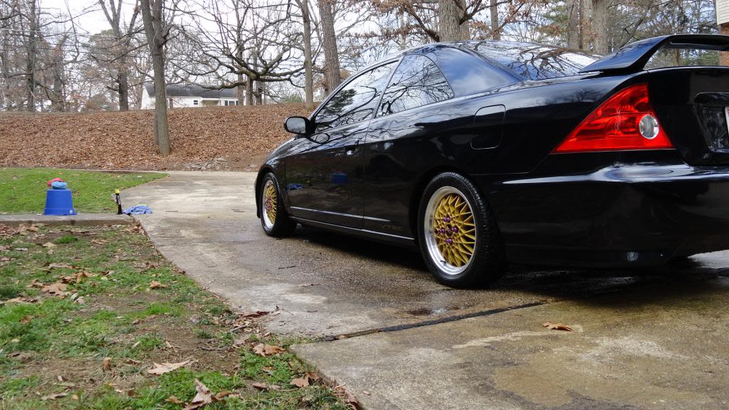

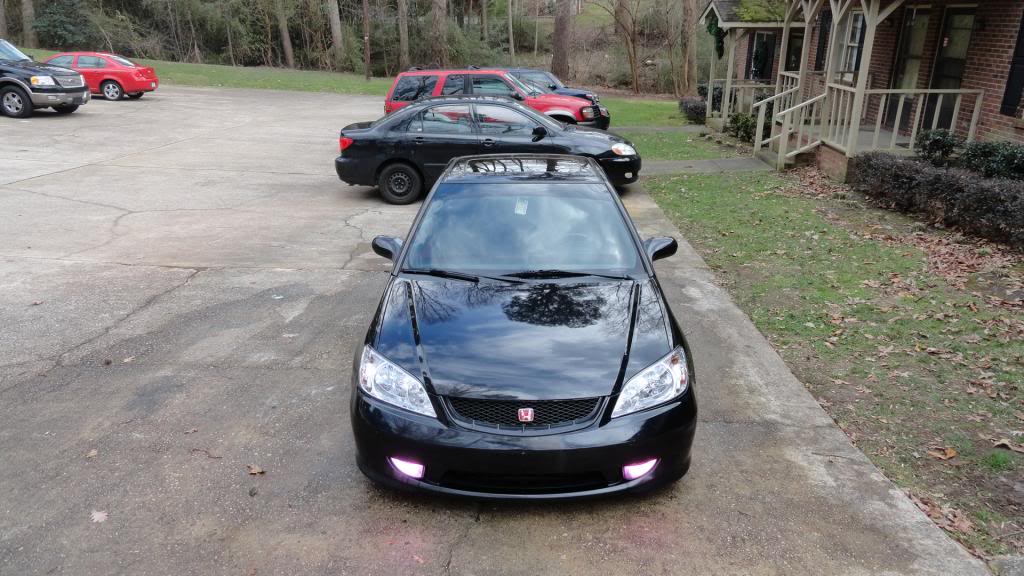

In the end, I was very happy with aesthetics and quality of the item (bought for a steal!) But just driving around every day that low got old.. In total I dropped 3 in the front and 2 5/8 in the rear for a perfect flush tire to fender fitment. Now ive probably raised both front and rear up an inch and a half hahaha! Here's how she sits now
