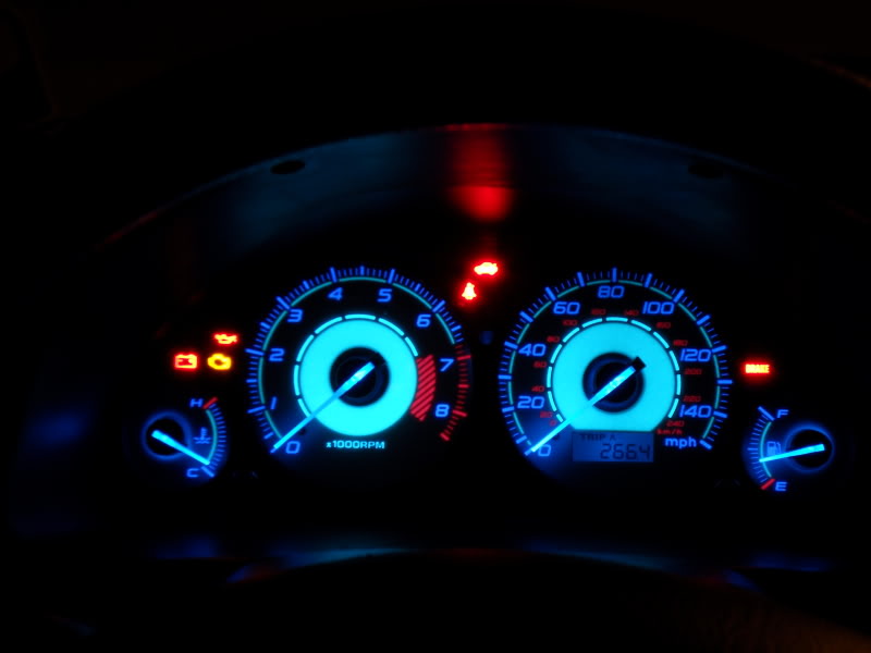

Result:
Note: As you can probably tell, I went a lot further, got myself a gauge cluster overlay, cleared my needles, and finagled LEDs to illuminate the thing. There are only 5 bulbs that illuminate the entire gauge cluster (needles and gauge face), plus one for the odometer.
