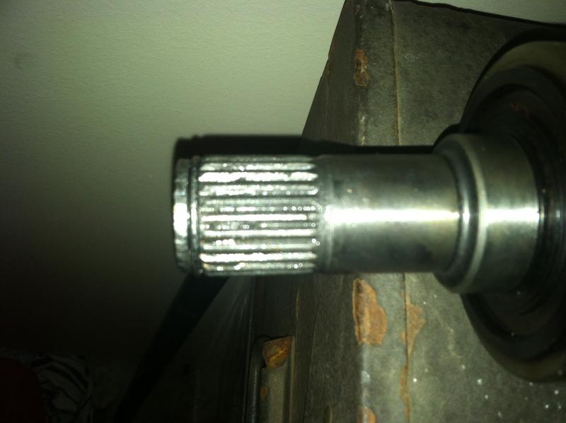

I have this problem with my transmission and was wondering if anyone could tell me what it is. The axel won't go fully into the transmission and there is a rod blocking it.

It goes back in about 1/2 the way it seems
There is still a snap ring at the tip of the axel and there is no twists in the spline. But the snap ring doesn't snap in

I'd need to compare to a fresh axle to be sure, but it looks like the short stub (to the left of the snap ring) used to have actual splines on it.
Like they got sheared down.
And it is keeping the snap ring trapped (or the ring never expanded properly to lock the axle into the trans).
The snap ring seems like it is collapsed or trapped in its groove now.
It should be able to expand so half the width of the ring is bigger than the splines, but right now it looks compressed.
I think you need to try a fresh axle.

yeah i was looking somewhere else that said the snap clip on the aftermarket axel would be smaller and less quality than the honda one that came stock. and i would switch them but i already junked the old axel.
it just seems like that rod wasnt there before. cause i sent the picture to my mechanic buddy who works mainly on hondas and said that wasnt normal. because i can feel the axel hitting that rod and stopping it about halfway.
