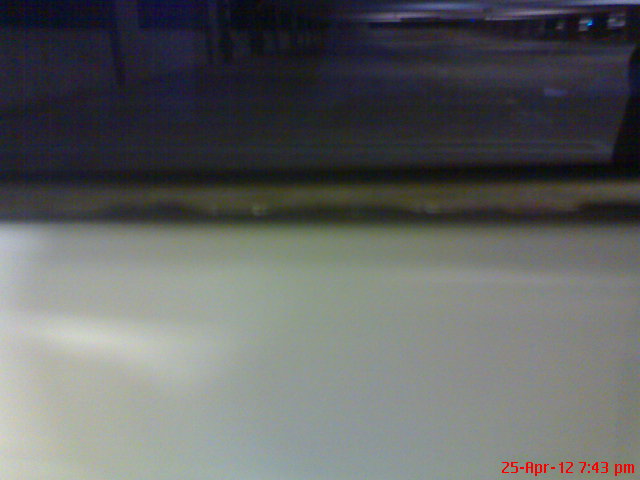

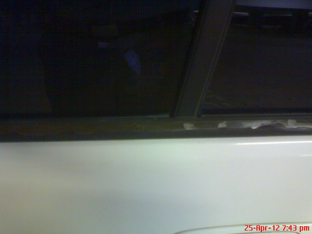

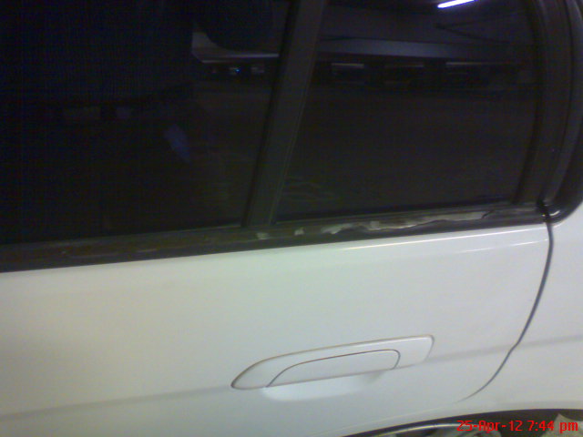

hello everyone,
I checked few auto shops but could not find the answer. I believe this can not be painted, as the paint layer would be too thin.
my car paint otherwise is really good but the window looks dirty.
what are my options?

Anything can be painted. I had the same problem area on my Integra, had a body shop paint it. No problem.

so what kind of paint to be used, i think with normal car paint will be able to paint it black but the original one is kind of thick layer (like a plastic)

u want to mask everything first except for that line. scrape off all that excess plastic paint stuff.
then clean it well. sand it lightly with 600 grit. primer it. spray a tough paint on it. (i use BBQ grill paint. that stuff goes on like it was powered coated.

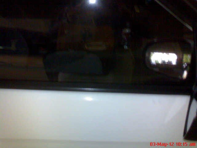

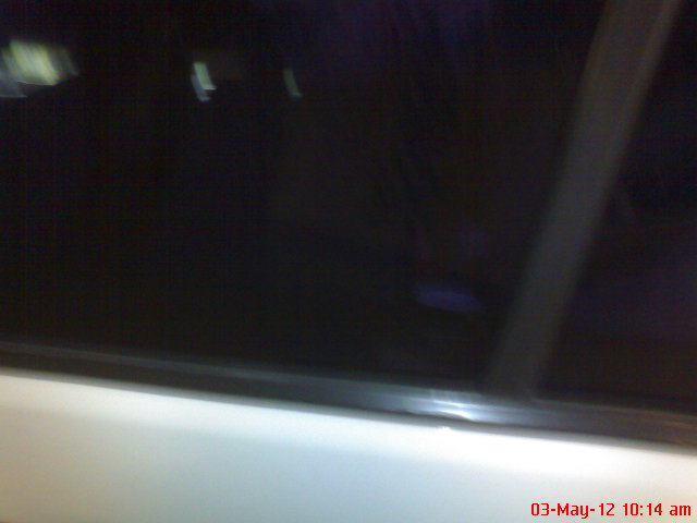

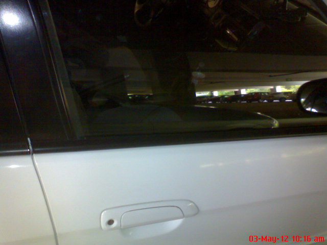

here are the images...
