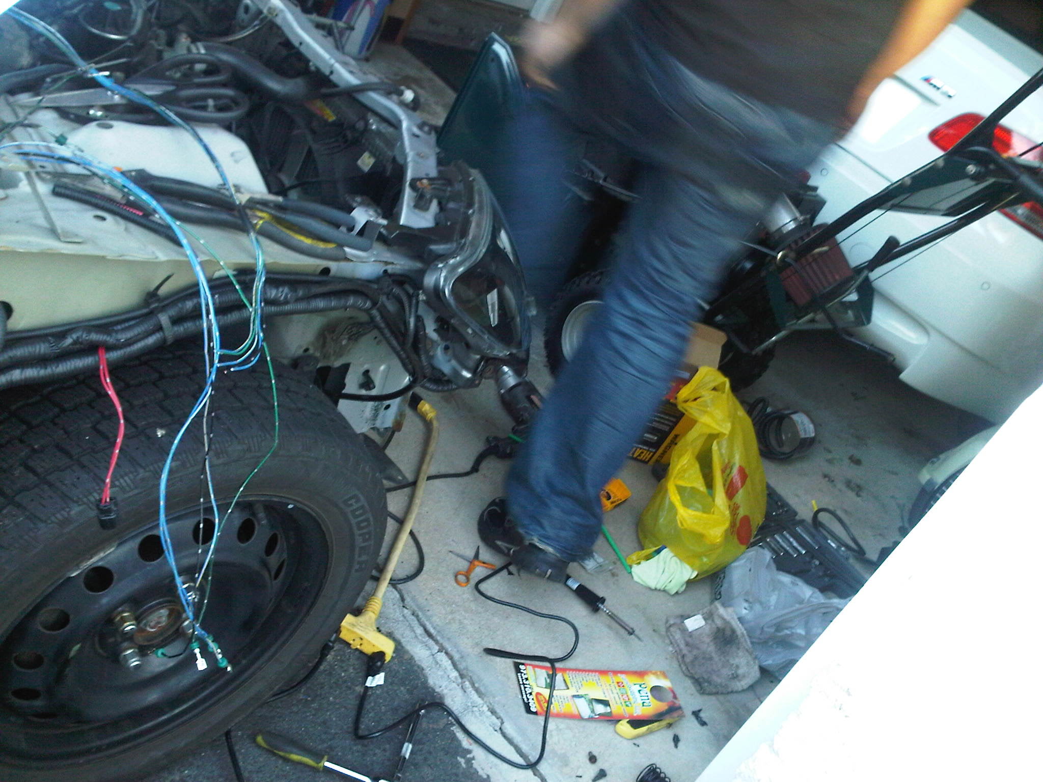

Almost stepped on the soldering gun. I'm a bit of a mess.

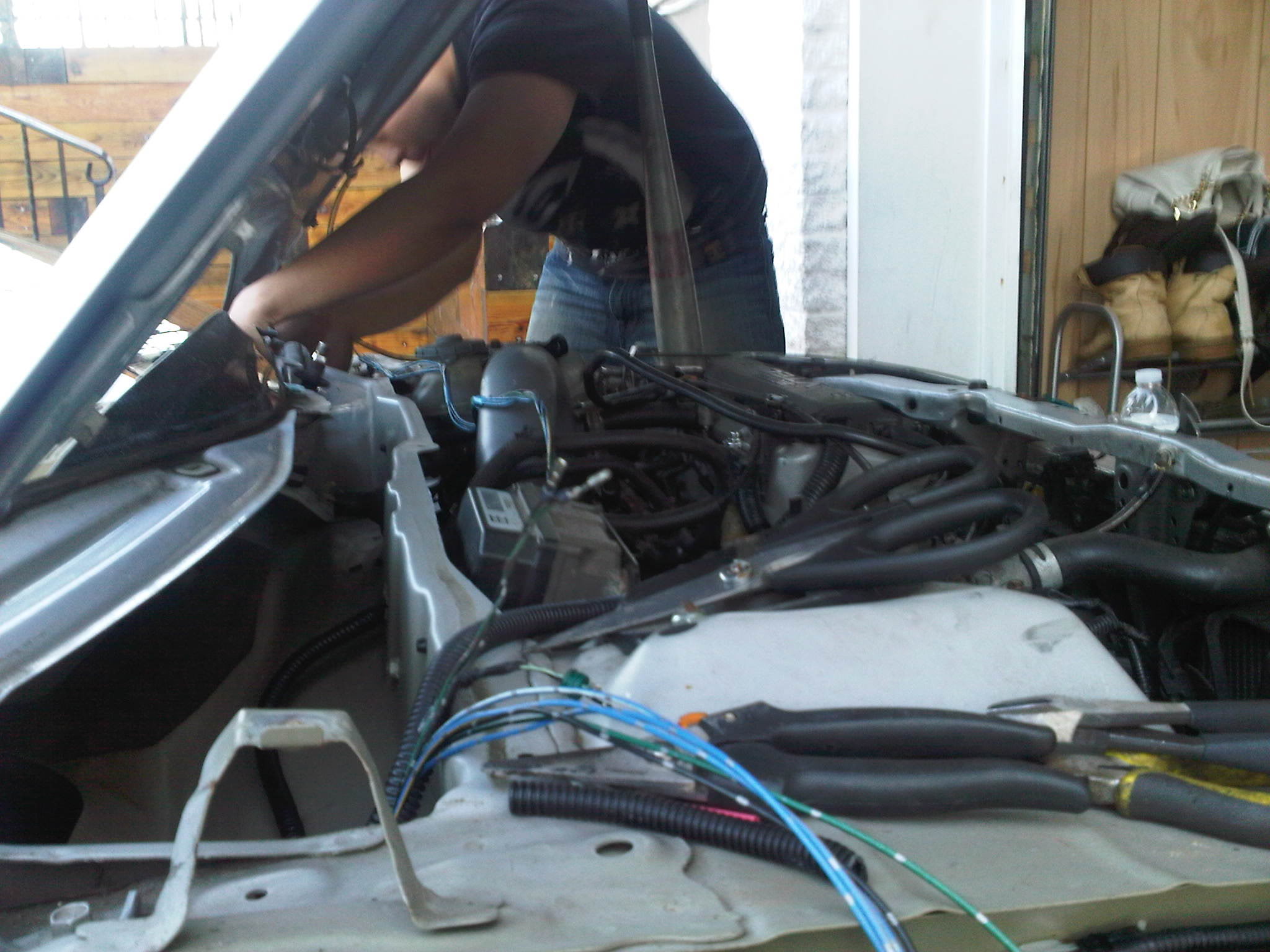

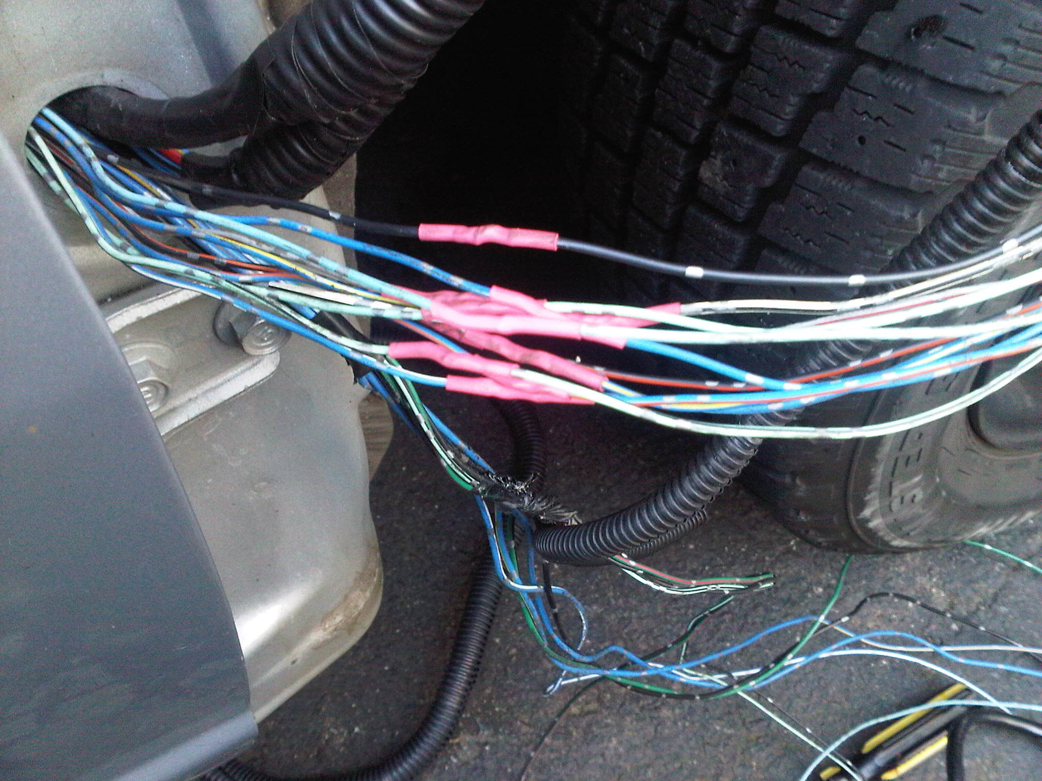

Measuring the wires for the wipers. Lol. And some of my tools.

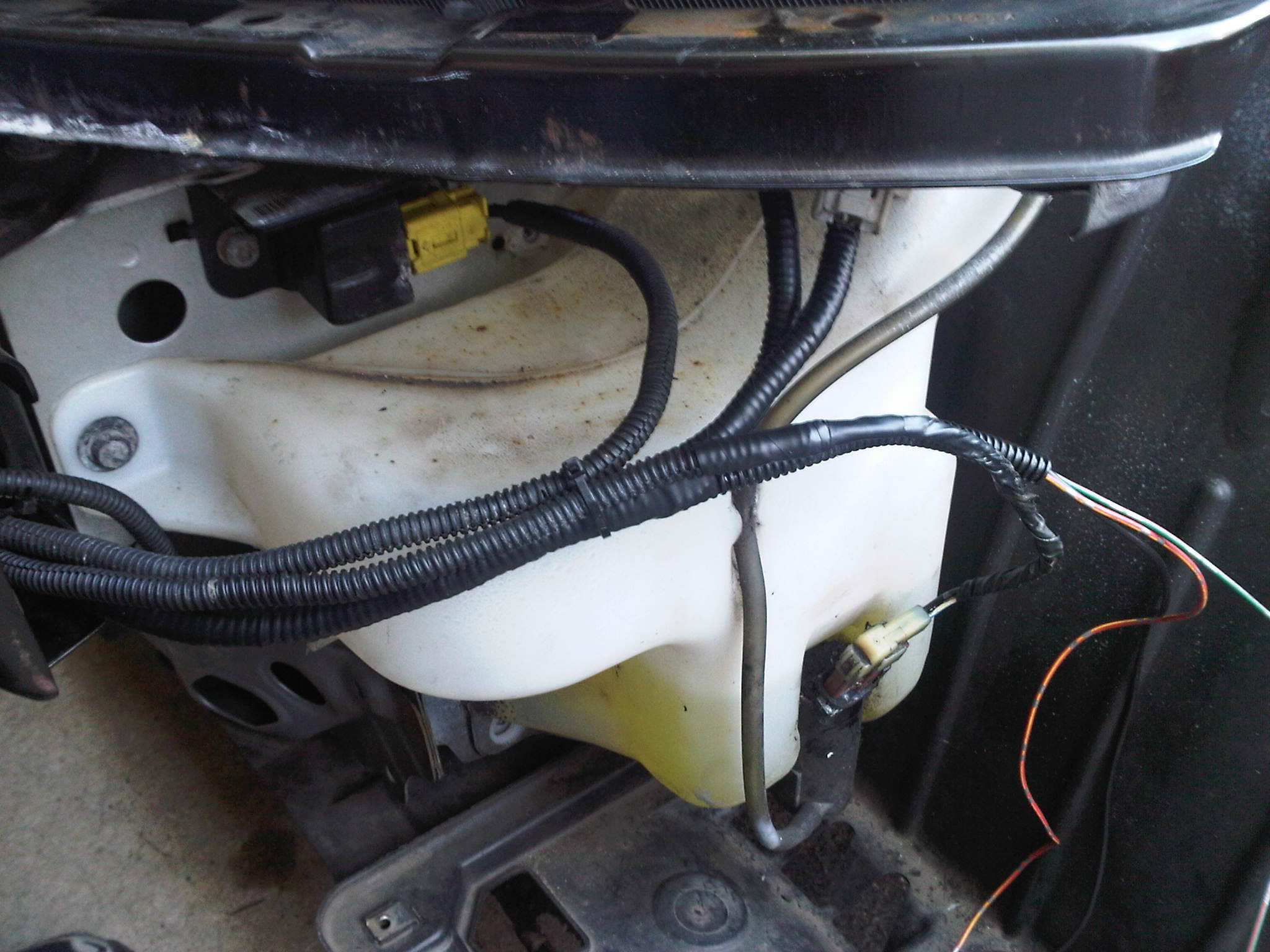

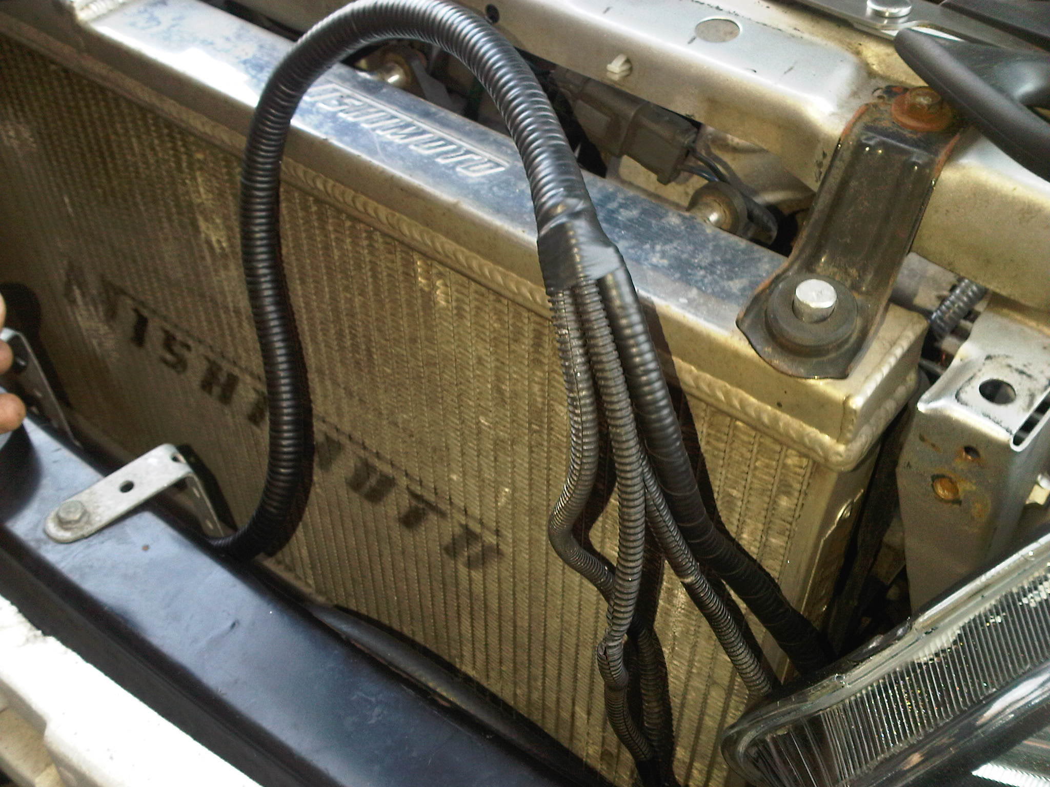

I decided to run the line for the driver side through the front. I don't know why....

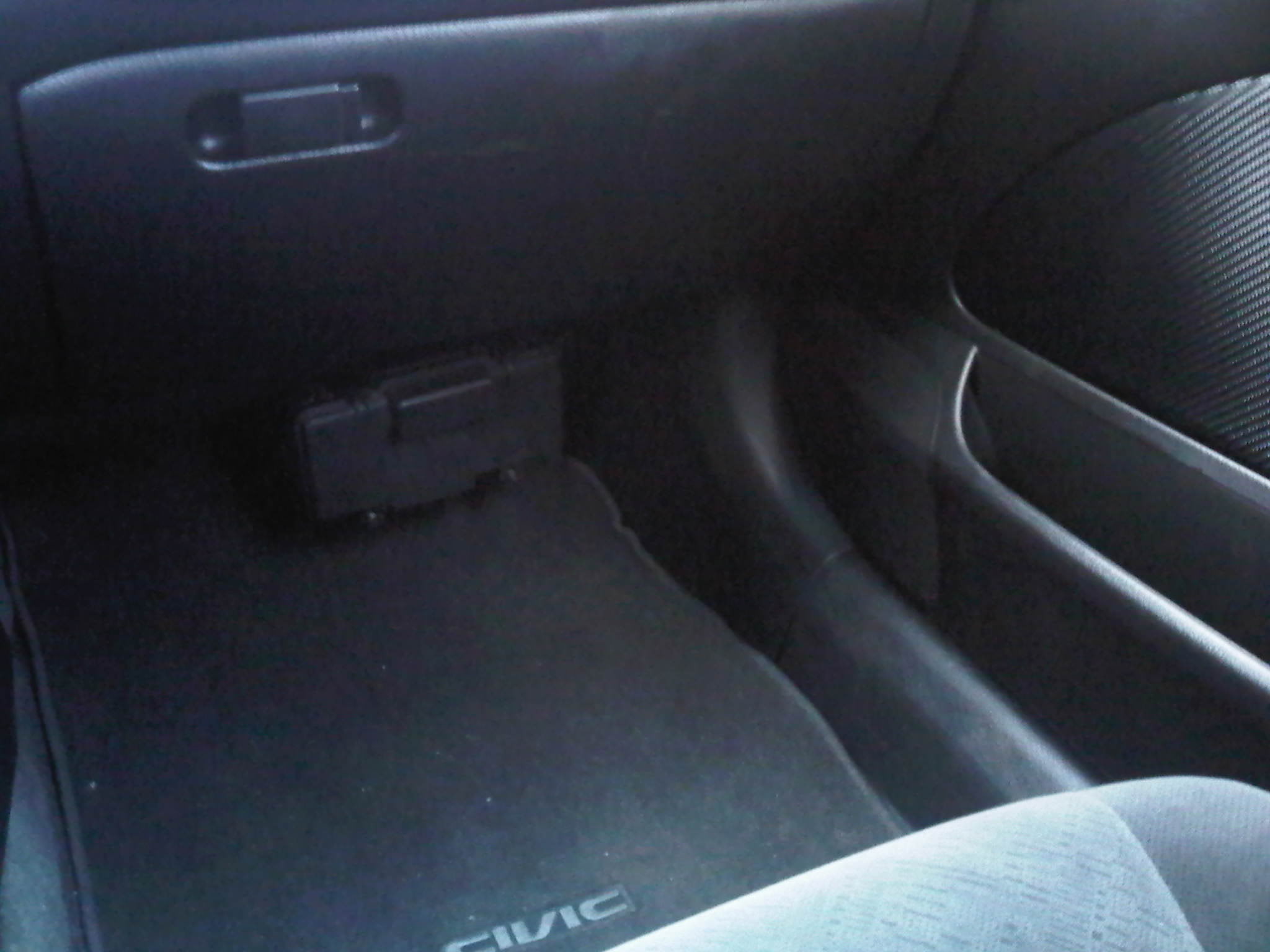

I put the Fuse Box here. I might change the location, don't really like it.

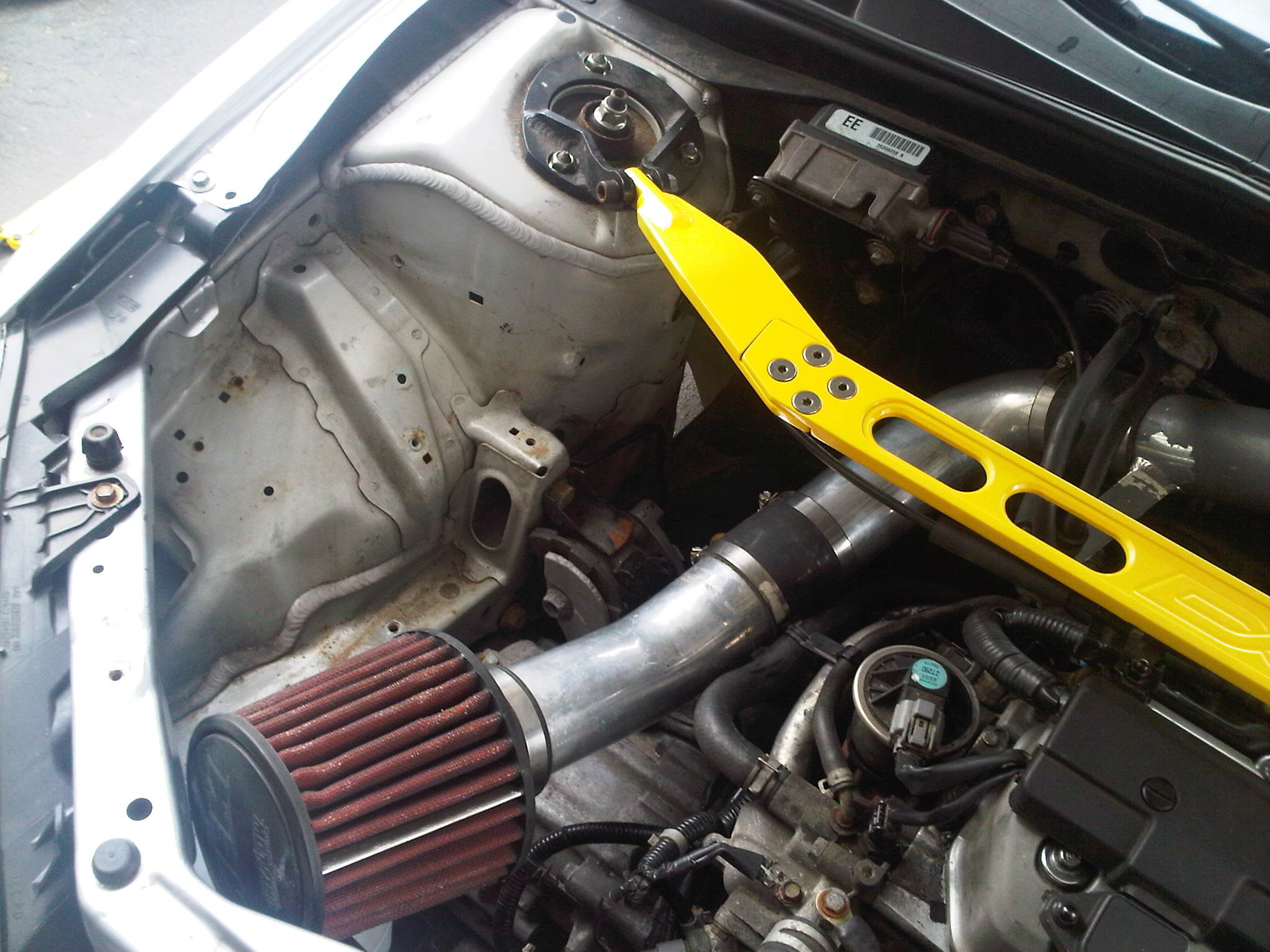

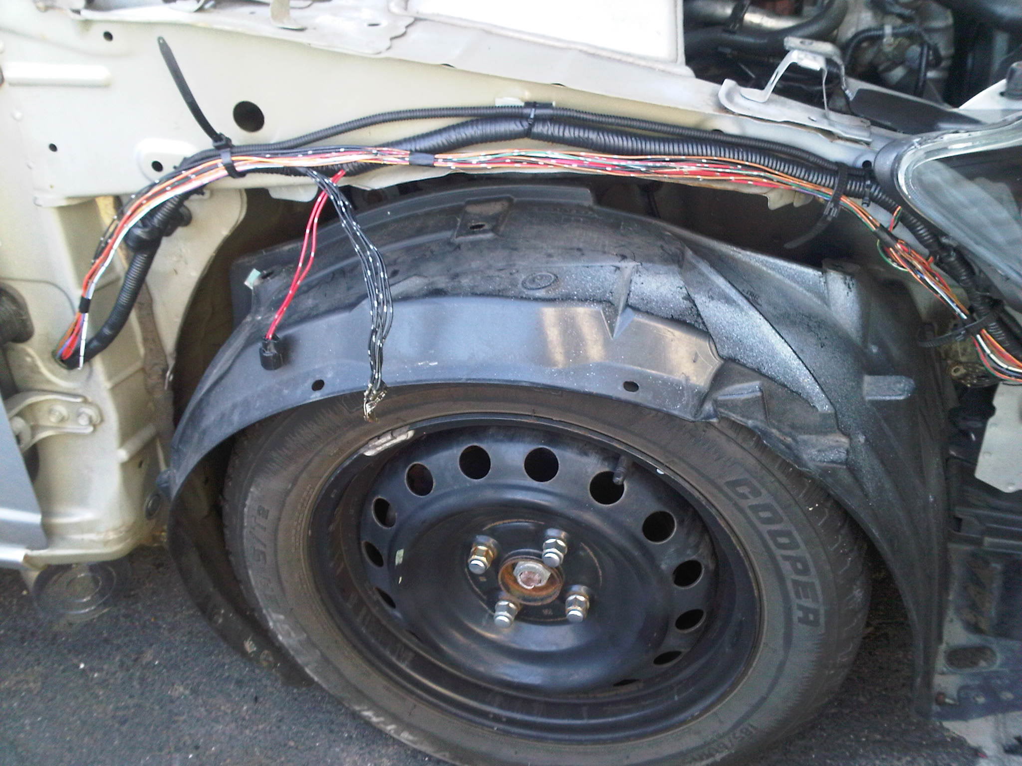

Here's the passenger side. I know its dirty as hell. I'll give it a shower when its all completely done.

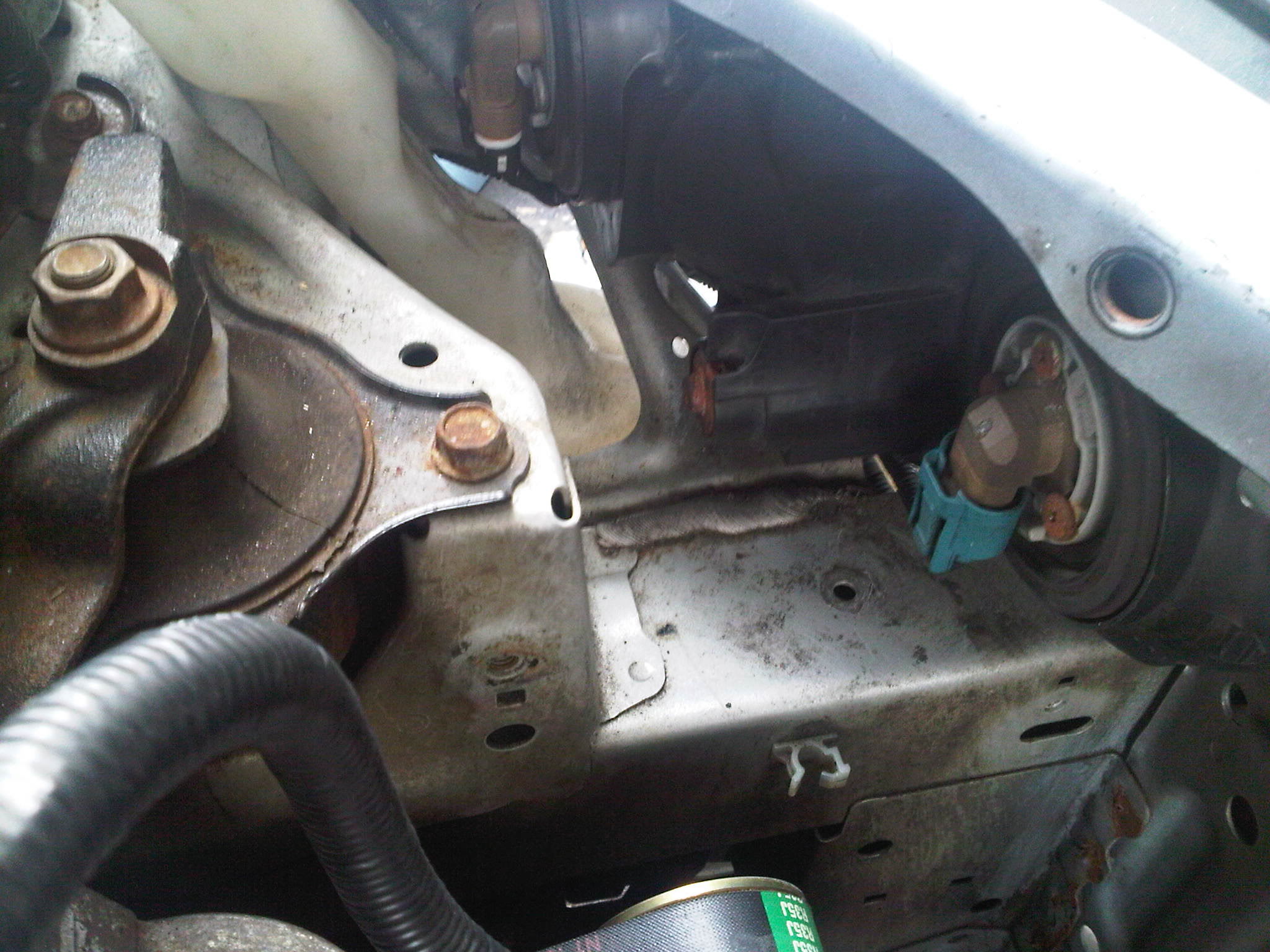

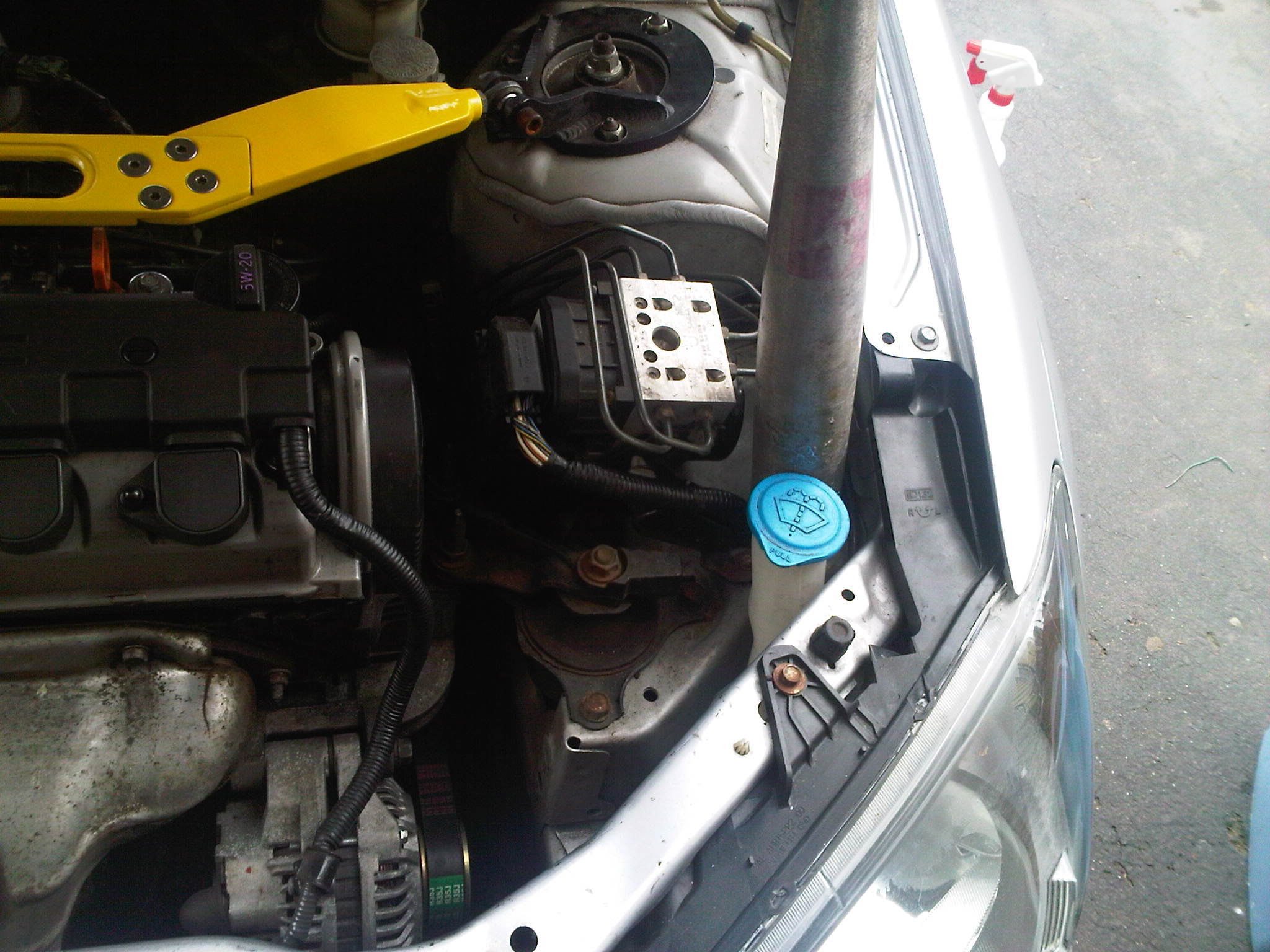

Driver side. I will relocate the abs in the near future, at the same time as the brake tuck I'm going to attempt. That's a baseball bat holding the hood open in case you're wondering.
And don't mind the wire from the alternator, just pretend it's not there. lol.

Looking good. I'm just questioning the practicality of having the fusebox in the passenger floorboard. I would have put it in the glovebox so I wouldn't have to worry about the passenger kicking it. I'm not even gonna talk about butt-connectors, that's a whole other thread. lol

Thanks. I didn't use any butt connectors. Every extended wire was soldered and shrink wrap. I don't even like butt connectors. Lol.
I did put a zip-tie on the connections, specially on when they split to places.
And yea, it was an odd place to put the fuse box there. I'll put in the glove box like you said. Thanks.

Looks really nice! what gauge wire do you have going to the trunk?
Should be same gauge as the battery cables.
If you're looking to relocate the battery just go buy jumper cables of the same gauge. Way cheaper than buying 40ft of 6 gauge @ $5/ft.

So im attempting a wire tuck right now. do you have power steering? because I dont see the resovoir
Old Mar 26, 2012
bryan.0831's Avatar
Joined: Aug 2011
Posts: 159
Likes: 18
From: North Jersey - Bergen County, NJ
bryan.0831 is an unknown quantity at this point
Re: Some cleaning to do..
No power steering, no a/c.
