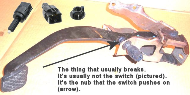

I've attached a picture. I've fixed this problem on nearly all my Civics. Why Honda hasn't corrected this design flaw after 20 years is a mystery to me.
I usually fabricate a little nub for the switch to push on. Just something to fit in the hole that's not to thick, but will not fall out.

dont know why they didnt just remove the piece completely and have the switch press directly against the brake pedal metal piece instead. maybe there is a way to adjust the switch reach so it doesnt need the plastic nub.

^^^ Not sure why they do it that way either. There has to be some reason for it.
Has anyone ever looked at any Toyota models to see if it is done the same way ??
https://www.civicforums.com/forums/a...2&d=1246629503
one of these clips with a nice flat face held with a tiny dab of goop it would last forever.
