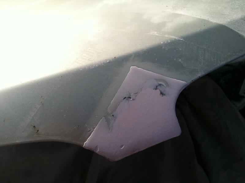

doing some simple body work
simple body work
grind out the rust
sand
bondo
sand
tape off
depending on thickness of coat(s) & type of paint
primex2
basex3
clearx4
untape smile

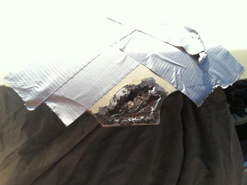

Re: doing some simple body work
Originally Posted by Heiserb
simple body work
grind out the rust
sand
bondo
sand
tape off
primex2
basex3
clearx4
untape smile
yes i know duct tape is not what your suppose to use when taping off however its all that was around the garage and i did it for free
