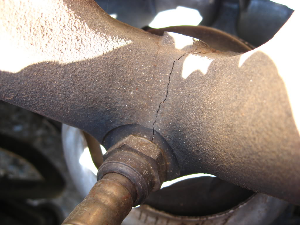

If you can SMELL it, and it smells like a lawnmower, then the leak is before the cat (between the engine and the cat). If you take off the heat shields, you may find something like this:
In this case, the manifold and the cat are one unit.
Most patching will be temporary at best.
Guess what you have to buy now....
Or maybe loose nuts or broken studs holding the manifold to the head. Play the lottery if it turns out to be this.

So i might have a crack in the Headers...Ima take a look tomorrow...If there is a crack DO i need to replace Immediately?

you might be able to patch it.
Ssssssup to you. I could elaborate at length about various issues it can cause, but I'm just not feeling it this evening.

I drove around with a cracked manifold for god knows how long...doesn't really cause much harm if it's small, but it would have gotten bigger if I didnt replace it, and then big problems would have started occurring. It could also just be the spring bolts holding the cat to the downpipe, or the gasket, which are both cheap, compared to a manifold replacement.
