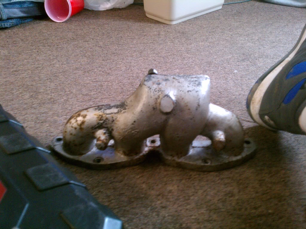

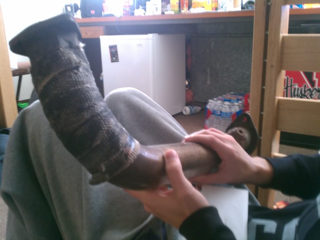

Well, I just got back from my trip in Omaha. Lets just say I made out well. Got my T28 turbo, exhaust manifold, downpipe and oil lines for....drum roll please.......
$200
Turns out im fairly good at negotiating. Ill post pictures *** soon as possible

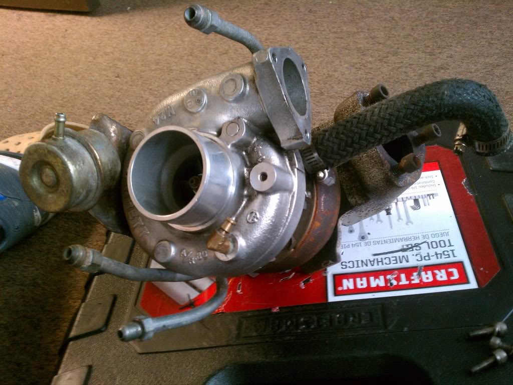

You even got a few inches of heat wrap included in the deal

This is kind of an embarrassing question, but i need to find a diagram of where I need to hook the oil lines up to the turbo, and what other hoses I need to get for the turbo itself. I have so many little ports on it, with almost no idea what goes where. Any body have anything like that?

Looks like the turbo is from a factory car. Then it probably has coolant lines running through it. Besides that, i have no clue

Yeah. Its from a SR20DET silvia
