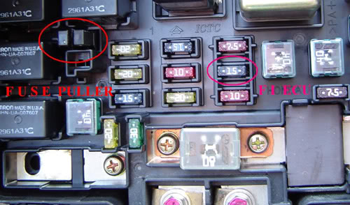

start the car and warm it to operating temp. you can drive around to do this and should not have too many problems except unsteady idle. park the car and turn it off. open the hood, locate fuse box, and remove the FI ECU fuse.
put the fuse back in, close hood, and start the car. let it idle for 10 minutes in park or neutral without using any lights/accessories or pressing the gas. after 10 mins, shut the car off. start it again and go for a drive like you normally would. it will take up to a full tank of gas for the ecu to relearn fuel maps and readiness codes. the idle will be set, but it may take a while until the ecu adjusts and you start getting good mileage again. do not perform these mods if you are having the car smog-checked immediately afterwards. it is a guaranteed fail. you need to wait at least 100 miles or more.
Old Oct 26, 2011
Rep Power: 812
Re: idling problems
to add some more info, i like to let the car idle a bit longer like close to 15 mins just in case. you should be hearing the cooling fans turning on and off during this time. keep the hood closed. if the cooling fans never come on, the car is not warmed up enough. be sure you drive the car enough to get everything hot. this might not be possible to do in the winter below freezing, and one of the readiness codes may not complete either.
