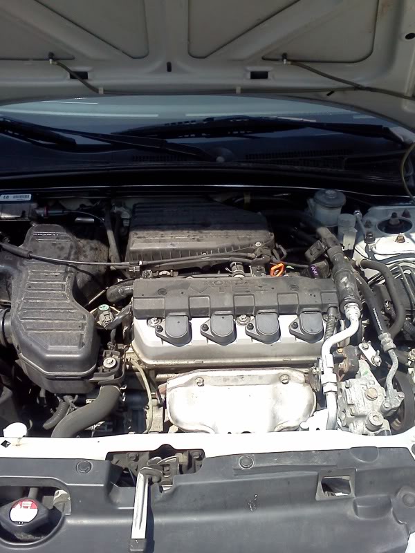

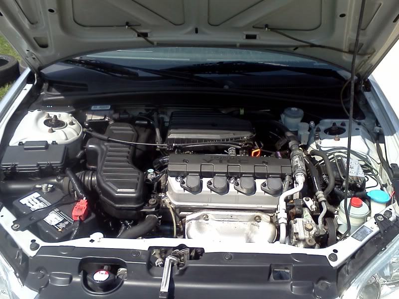

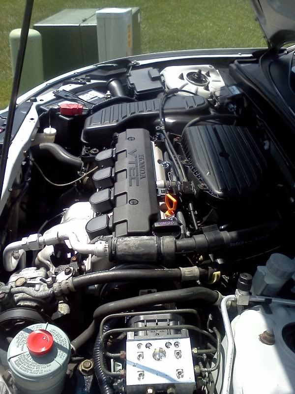

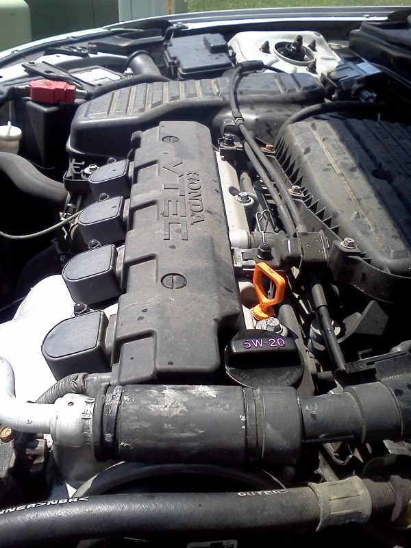

I just covered the alternator and doused the whole engine in simple green. Worked well for me.
After

Re: Degreasing the engine bay
so much better. if you have more time, you could get a plastic protectant and wipe down some of those black plastics. and metal polish some of the a/c lines.

^ LOL
Nice before and after. Yeah, I agree with Gearbox, about protectant and metal polish. Back in the day, I waxed everything, dust/dirt would never stick. I got that tip from him years ago, when I saw a pic of his engine bay. Now that's an immaculate engine bay!

Yeah I need to get something to coat the plastic. But meh.

I could be wrong but its safe to get the power steering hose and pump wet? I covered mine.
