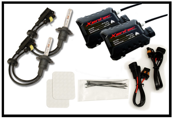

I just installed a 35W 5000k HID kit for my night headlights the 9006 low beam but something definatly went wrong.
. I live up north CANADA and good lighting is a must)
I have pluged the car wires(wich used to go directly into the H4 bulb) directly into the balast (didn't use the small extensions you can see on the image since all wires had the right lengths) and the balast to the HID bulb.
This is exactly the kit I got.
When I first started the car my DRL lights lighted up ok than when i switched the night beams on for the first time (the freshly installed HID's) the DRL obviously went off(normal) and the HID's came on, and i noticed that the driver side HID light was flickering. OUCH. I tried to put on the high beams and they worked along with the flickering HID( the driver side seemed to flicker more and also seemed to have less energy, it looked more like a 4300K than a 5000k.
Stopped the car triple checked the wiring, and now when I start it back the DRL lights wont light up and in my DASH the DRL indicator is on
If I switch the HID's to on they light up ok with no flickering now and the right intensity. Also If the HID's are on and I try my HIGH BEAMS along with HID's everything seems to work just fine.
But I still dont have my DRL's when I start my car.
PLZ HELP!

Hi thanks alot for those explanations, meanwhile I found myself some answers.
That first day i had them installed and that one was flickering I used the car at night and the problem seemed to had been solved. Everything worked fine.
But when used High Beams and Hid kit low beams the light started flickering again and ahaha a few minutes later The other Light Died out.
next day
I switch the bulbs and i notice it's still the same light not firing up.
I switch the balasts and notice that now the light works
Result: Faulty dead balast.
I had a spare Relay harness from an old kit I had with another car and tried it and now both lights werem't working - which I thinks it's still odd since it's plugged in parrallel like the christmas lights if one goes out not all die out. anyway it's just a supposition, I'm not good with electricity and all that stuff.
I than inform the seller of the problem and instantly he replies
I'm sorry for th faulty balast I am sending you higher quality ballasts -ahaha
As if the guy knew he sent me crappy balasts.
So now I'm wating for new balasts and meanwhile I installed old Sylvania pure white something regular bulbs and I think i wont even use HID kit, The sylvanias are very good. I will still try the new kit to give you some feedback.
I still wonder why relay harness made both lights go out ???
