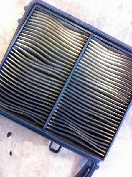

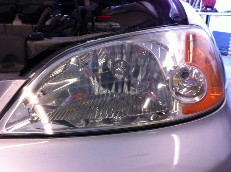

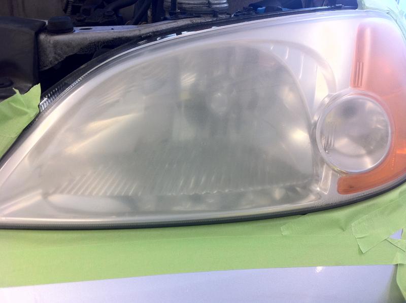

kinda boring and crappy pics, i for got my camera
Nice before and after pics of my headlights
I used the 3M kit http://goo.gl/ZzILh, and i'm sure i could do another 6 pairs of lights with what i have left

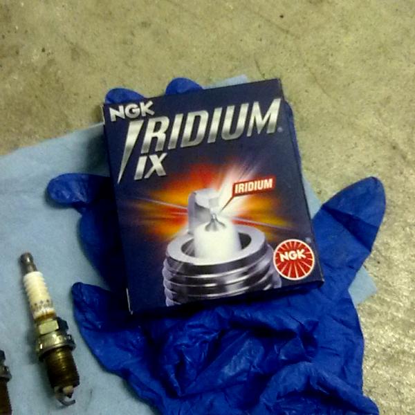

i changed my plugs to NGK G power plugs, i went with a fram air filter(no pic)
I"ll have more "in depth" pics of my work to come

nice shiny headlights! makes the car look much newer i bet
oh for sure!, i couldn't be happier with the outcome

Hopefully you changed the spark plugs with the engine cool Those headlights look awesome, it's nice to stay on top of maintenance too. Don't forget to check your ball joints and stuff. Even with 10 year old bearings I wouldn't replace them unless they were shot.

I agreed, the headlight looks so new.

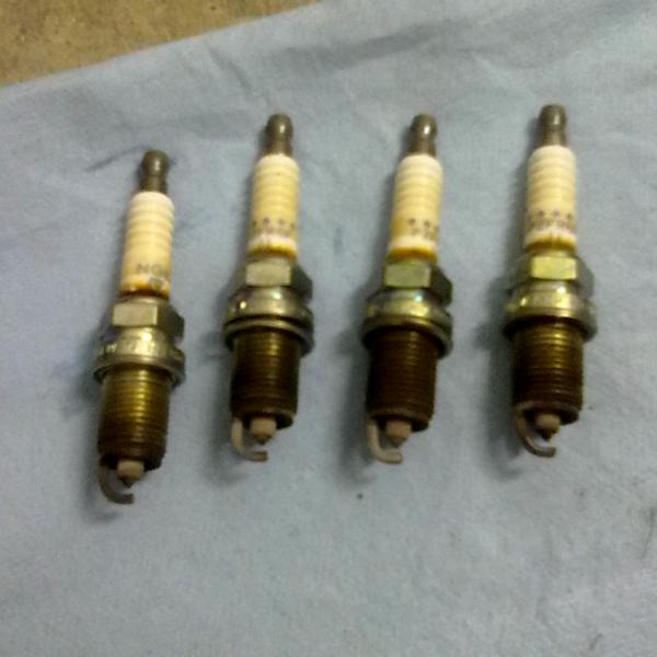

I just changed the plugs last night also. I'll share the look of the old plugs.
