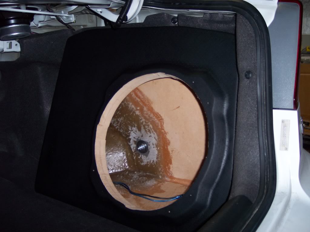

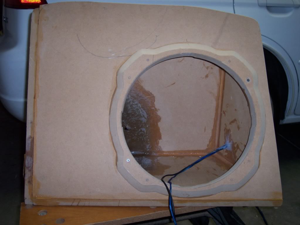

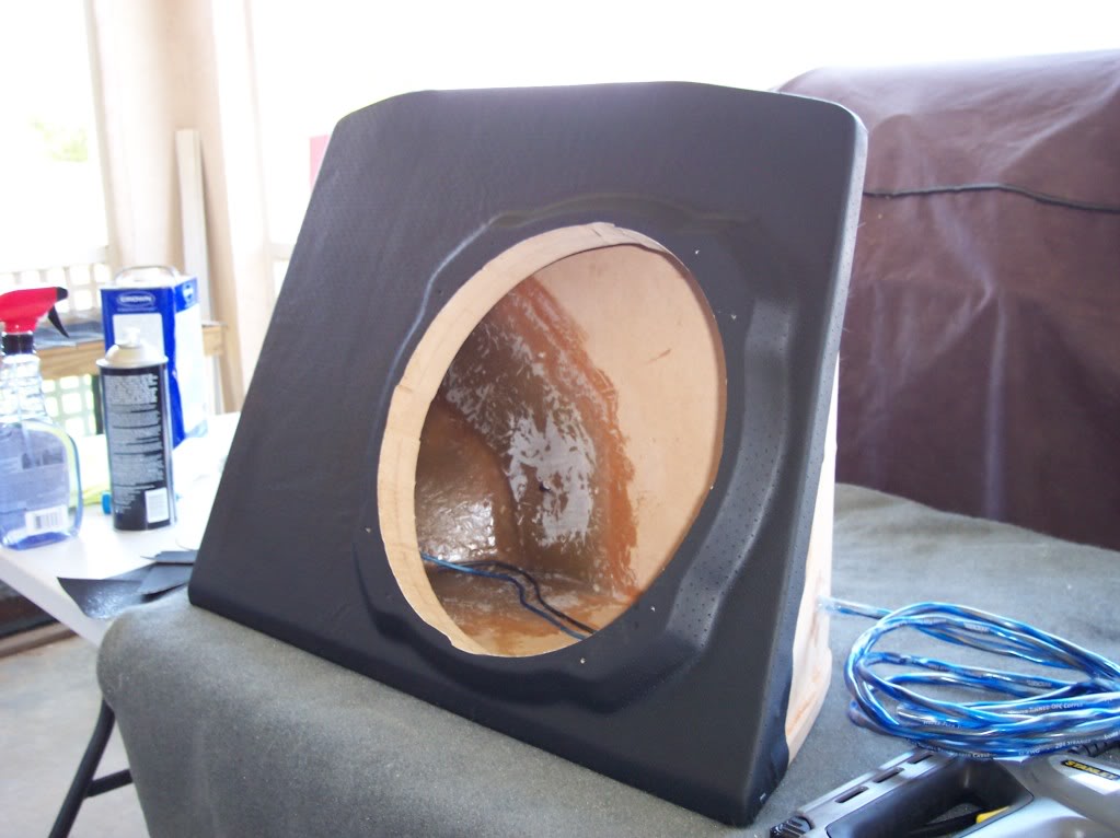

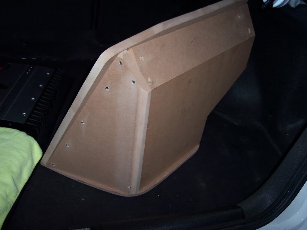

Finally finished my sub box and installed it. just need to put the grill on . Sounds great.
here is a picture sequence

Couple questions:
What's that material you used to cover it?
You decided not to go with a speaker terminal and routed the wires inside only?
Is that like 12 Gauge speaker wire?
Any pictures of inside?
Would like to see how you bolted it down

What's that material you used to cover it? Marine Vinyl it has good stretch capability. the local upholstery shop just let me go through their rack and pick something out.
You decided not to go with a speaker terminal and routed the wires inside only? I dont like terminal cups they are normally thin plastic and creating a bigger hole increases the possibility for air leaks. i also use silicone 1 to seal the wire to the box from both sides.
Is that like 12 Gauge speaker wire? Good eye, yes 12g twisted with plastic shield.
Used foam seal tape then neoprene washer ,metal washer and nylon lock nut. to secure the bolt to the car i went through the trunk brace and used fender washers and nylon lock nuts so it would not spin on the nut inside the box.

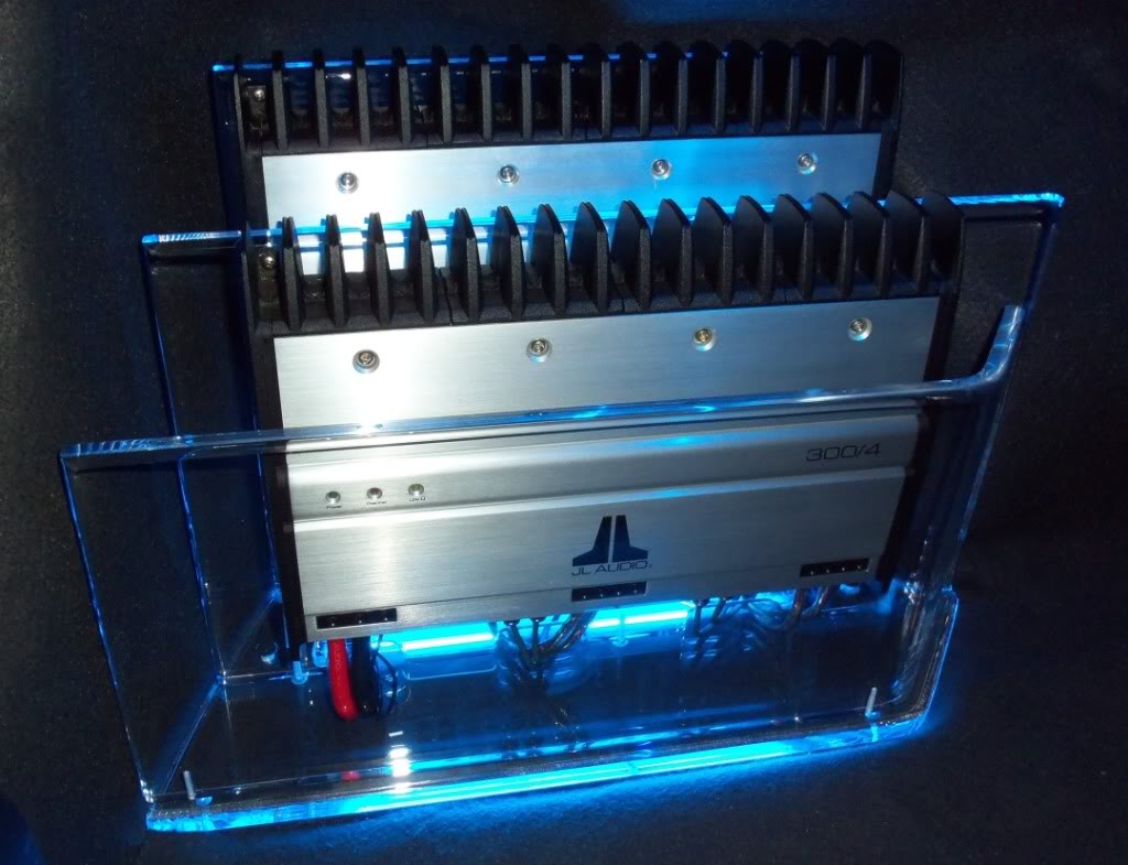

Picture with Grill and on the finished amp rack.

That is one sexy amp rack
Lovin it
Howd you get the glass to curve?

the Glass took alot of patience , a heat gun and low heat for a long time till it starts to bend.
