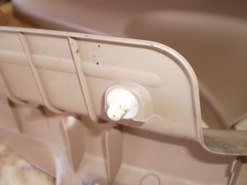

If you plan on taking out these panels beware of the panel poppers! They hold all of these four panels in, so dont worry about hidden screws. I encountered zero on the panels.
