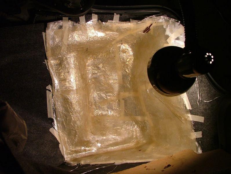

Started building some custom sub boxes. fiberglass enclosures, btw i am keeping the spare tire...putting them behind brake lights.... mounting the amp in the spare tire compartment...going to enclose it with some metal and have a cooling fan...which turns on with accessory (unless if my head unit has enough power on its amp line to run a small relay). will post pictures as i do stuff.

4.75" is the depth of my subs. It is going to have may be 1-2" clearance in the back....the volume is going to be around .35 cu ft (~41cups). measured my fiberglass it was close to 43 so i just need to do some shaving.

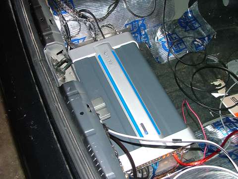

Well Here are my finished subs. Lot of work for a guy who never did it before, but I am so happy to have a functional trunk...
totally worth it.
I have a left one as well similar.
location of amp.
Now I can use my trunk space to full extent, with having a spare, jack, and all the junk you want to carry around.

Since before this I never worked with fiberglass, so it was difficult for me. But the second one went smoother.
The boxes are two piece, fused together. I have a mdf board face.. with fiberglass back.
To create the fiberglass back I used thin aluminum foil with double sided tape to form a shape of the trunk lining. Then i started to build layers of fiberglass inside the trunk itself. Two layers.. then let it dry. Now you got the shape you want for the box. Just build up more layers once you clean the aluminum foil. Now make the mdf front face and fuse the box mdf together. Make sure the location of the hole in mdf is in right location so there is enough depth to accommodate the sub. {you do have to trim the mdf to fit the shape of the box...}
I just gave you the gist of the things. Will see if I have any pictures of the boxes.. and will post if i find some. Will take some pictures of finished box inside the trunk.

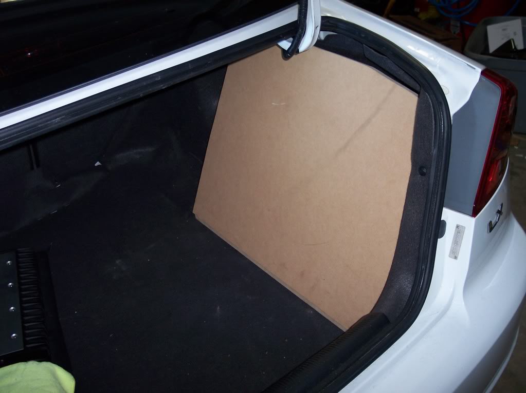

i built mine mostly out of wood .still working on it but here is a pic . it is .8 cubic feet and there is a jl 13tw5 going in it

tw5's are shallow mounts correct?
It'd look great
subscribed to see final product

that does look really good, i would be scared to work with fiber glass since i have never worked with it before, so your all wood box sounds like the right plan for me.

yea the tw5 is a shallow mount and the part where the wheel well hump is will be fiberglass but ill post the progress its kinda slow been working alot.
