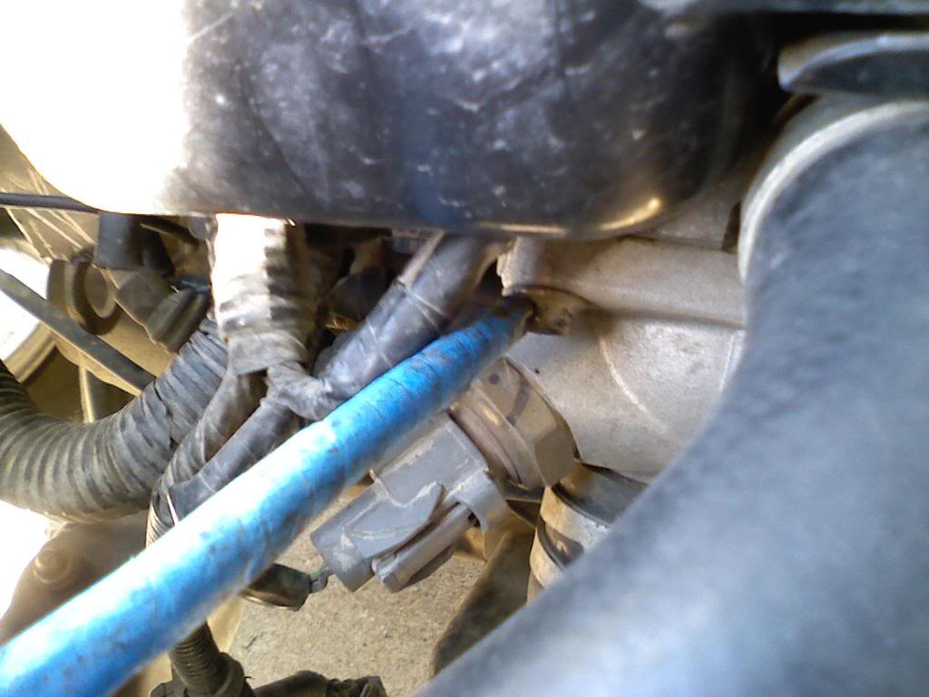

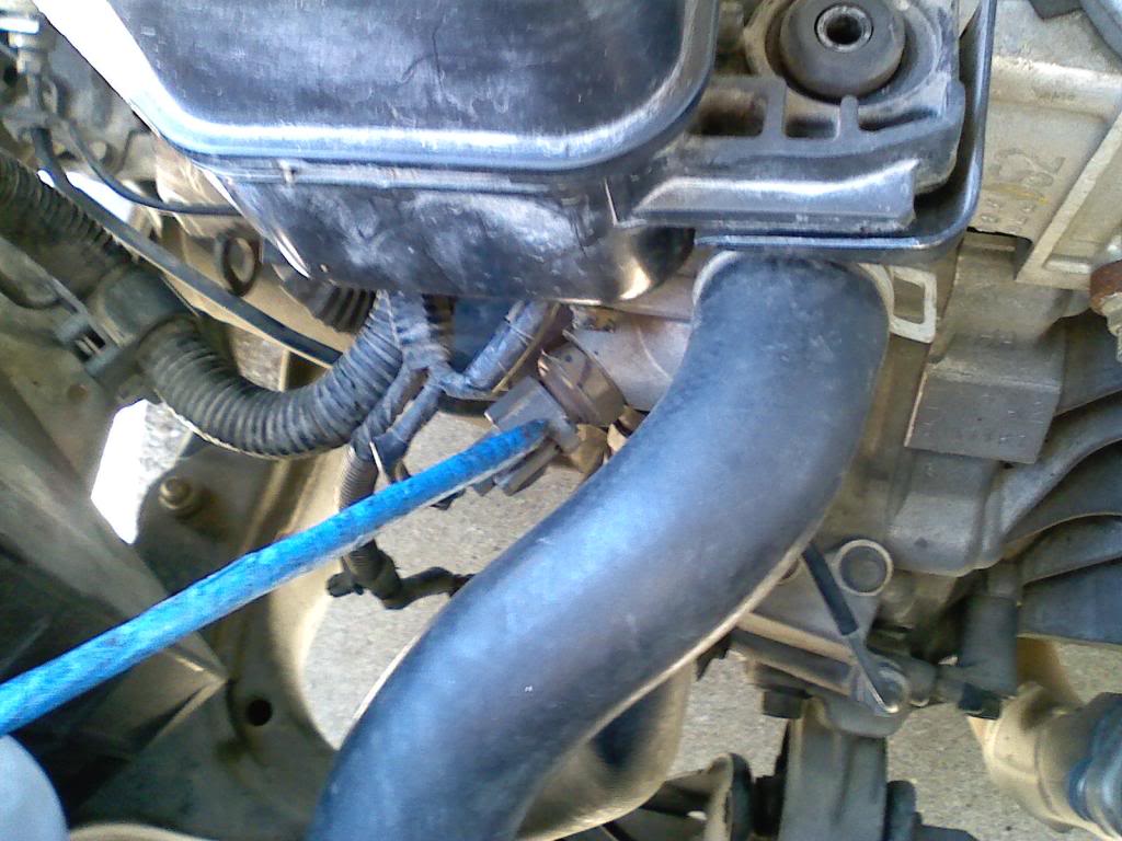

Thermostat DIY:
1. You can either drain the coolant or disconnect the lower radiator hose and put it to the side. You'll lose a cup or two of coolant but, not a lot.
2. Disconnect the connector:
3. Unbolt the housing bolt:
4. Unbolt the other housing bolt:
5. Remove and replace the thermostat (it only goes in one way).
6. Replace the bolts, the connector, and the hose.
7. Bleed the system.
