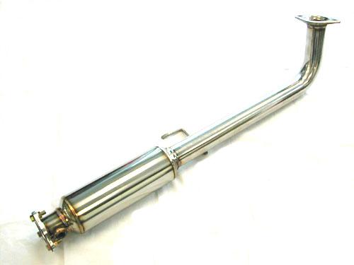

i was thinking about going with the magen racing cuz its only 100 bux shipped

Megan's only a test pipe, not a real cat..

Re: best catalytic converter for ex
whats the diff

The megan "cat" is just a resonator installed in the downpipe.

If you don't care about emissions, go for it.. Your car's gonna throw a CEL without an O2 simulator, and even then, sometimes the CEL pops up..
