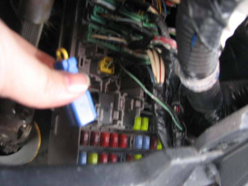

Wish I saw this earlier : SRS Airbag light can be reset in 5 seconds. And for $5.00 (if you want to buy the jumper Honda uses). Normally its caused when the SRS wires under your seats loosen (or if you disconnect the SRS wires without first disconnecting the battery.
Look for the fuse relays under the steering column on the driver side.
You will notice a Yellow "Plug" with 2 Wires running into it. This is the SRS Airbag Relay.
1. With the Car in the Off position unplug this "Plug" and Insert your jumper wire into the Male end, (the Yellow portion with the wires).
2. Turn the Car to the On Position (Do not START the car). The SRS Light will turn Off after 2 seconds.
3. As soon as the light turns off, Remove the Jumper wire, the SRS Light will Come Back on.
4. Once back On, Re attach your jumper wire, the light will turn off
5. Remove the Wire, and the SRS Light will flash 2 Times and Turn off.
This Process Resets the SRS System. (if no errors are found and the system is good. the light will stay off)
Heres a picture of the SRS Relay and the Jumper Honda sells.

Is this the same as the paper clip trick I've seen floating around the web? If so, I've tried it with no luck
Old Sep 18, 2010
down_'s Avatar
Broken Arm, How Am I Suppost To Shift
Posts: 546
From: Las Vegas. NV
down_ should not be trusteddown_ should not be trusteddown_ should not be trusted
Re: Airbag Light On
Dont use a paper clip. For Multiple reasons.
The first being your just grounding out the wire when you hold the paper clip, not to mention alot of other voltage problems.
Use 12g wire. Same Idea; Cut about an Inch of wire; strip both sides; insert one end into one side of the male end of the plug and use the other to Connect and Disconnect the other.( Your pretty much just making the Honda jumper)
It should work; this is how i fixed it the first time. You need to watch the timing on the SRS light. if you dont get the connection together in roughly 3 seconds. It wont work. And you'll have to start over. If I get a chance i'll take video of it and upload it to youtube.
