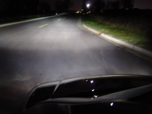

heres an idea what it will look like with shield. my old catz h4 hid kit in 02 civic reflector. there is still some glare, but i never got flashed even once while driving.
