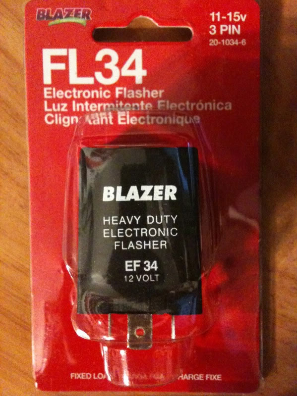

You can pick one up at a car parts store (pepboys, autozone, etc).
I grabbed one that was a tridon ep34 equivalent, but it was too big to fit in the OEM spot.. I'm gonna try another store to find a no **** tridon ep34 one tomorrow
The one I got was a blazer FL34
