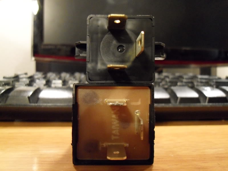

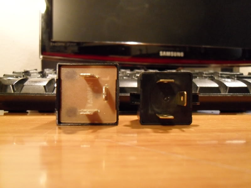

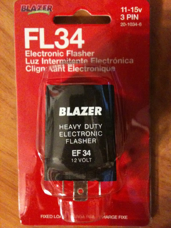

Just giving everyone a heads up with interests in LED turn signals and replacing the flasher relay, the Tridon EP34 equivalent Blazer EF34 (packaging says FL34) doesn't fit into the slot for the OEM flasher unit. The tridon unit, I think, is a bit smaller than the OEM unit, but fits into the stock location just fine.

Blazer EF34

Side by side comparison, OEM on the right, Blazer EF34 on the left

Old May 28, 2010
Re: LED Tail lights and Load Resistors
hmm and the blazer says "fixed load" so i doubt it wouldve worked. you want LED or "no load" flasher so it doesnt hyperflash with led bulbs hooked up. go with tridon

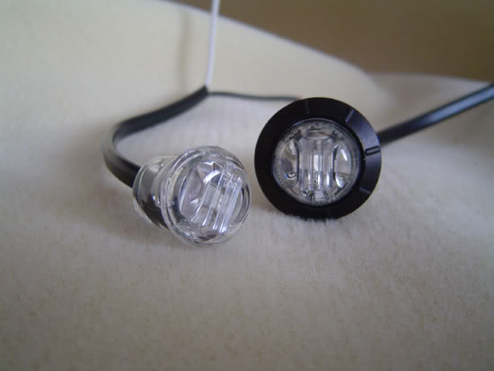

yeah its the customdynamics.com genesis cluster with 5mm leds. really sharp without any covering on em. the tyc diffuser kills the intensity. heres an old comparo to the stock tyc filament bulb, which ofcourse is the brightest bulb ever made so its not really a fair test. alot of other car with lower watt bulb and different reflector prolly wouldnt be as good.
parking light comparo (i disconnected the park light function tho later). led is brighter (right).
turn signal, bulb is brighter. this is 500 lumen 3457 amber bulb. (bulb on left, led on right)
led parking on the floor
led turn on the floor
the led park light on top is just a maxxima truck light module with 3 amber SMT leds
when i had dual park lights testing....but it was too much amber so now just the top is park and bottom is signal.
