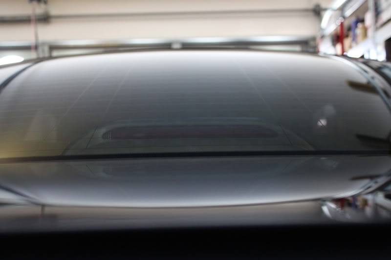

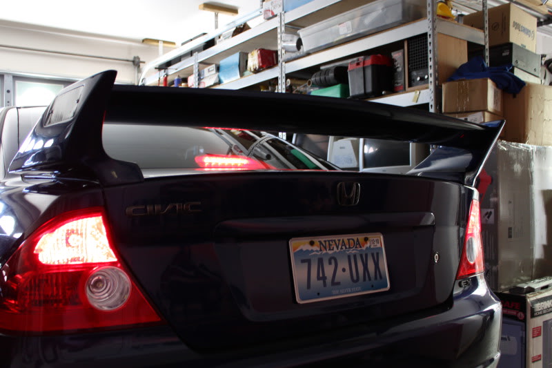

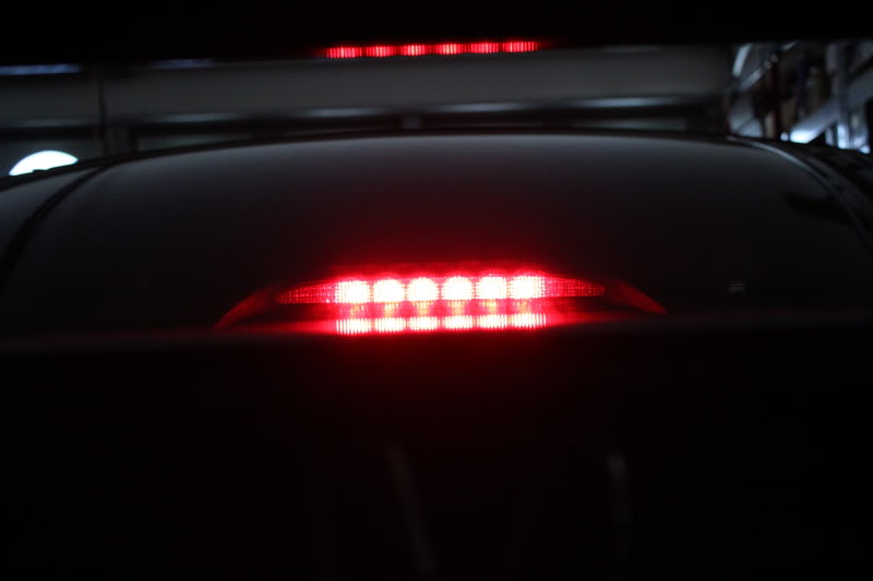

Welp, installed the 8thgen 3rd brake light. I mounted it using 3m double sided tape, and a strip of duct tape on the bottom to keep it from moving.. I was stoked when I got the unit and found out that the electrical connections are straight plug and play. In any case, it works perfectly, and without messing with my cruise control module, my cruise control works fine, despite having all LED brake lights

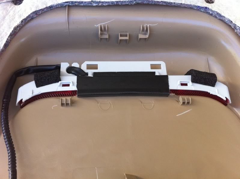

Lol, yea, I fully expected to have to chop the connector off and make my own out of spade connectors. I took it out of the box and went, "hrmm....." Went out to my car and decided to test out the connection. Plugged right in, so I went and stepped on the brake pedal, and it lit up.
and this is where I applied the duct tape.

i used a thick bead of silicone for that spot. tape may come apart in the heat over time...which led bulbs do you have for the brakes? those smt ones?

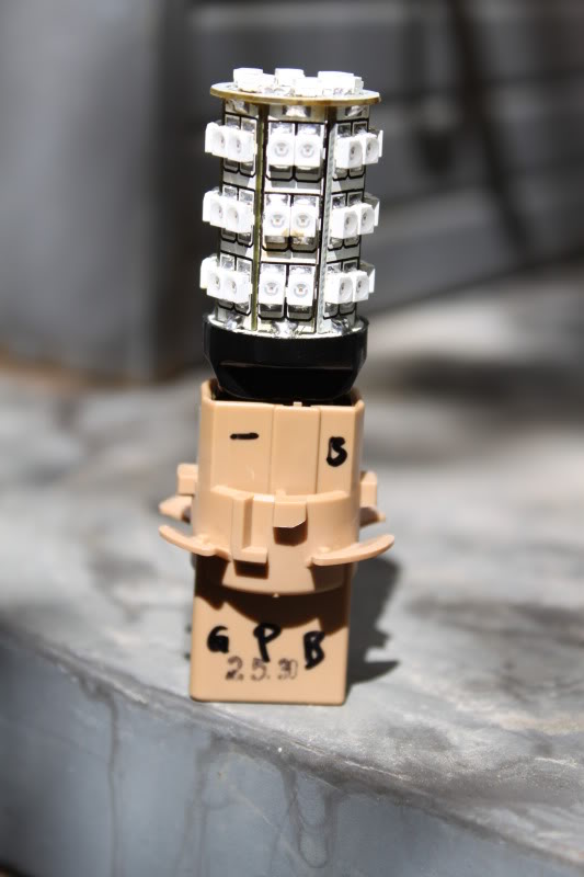

Re: LED Tail lights and Load Resistors
yep. I got the same bulbs for my rear turn signals, too.
7 boards on the side, plus the one on top, 6 LEDs per board.
