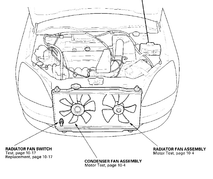

Ok I found out the problem my fan doesnt work .. it only works when I turn on my a/c thats why its not overheating when my a/c is is there a switch for it or a relay to turn it on ? where is it located?

Unplug the fan switch (see below) and short the 2P connector with a jumper wire. If the fan now runs with the key in ON(II), then replace the switch.
