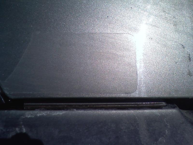

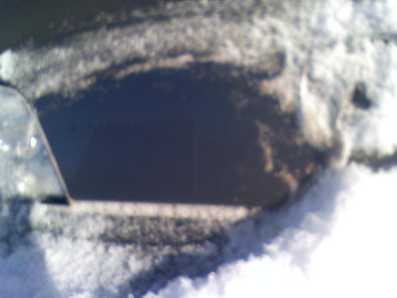

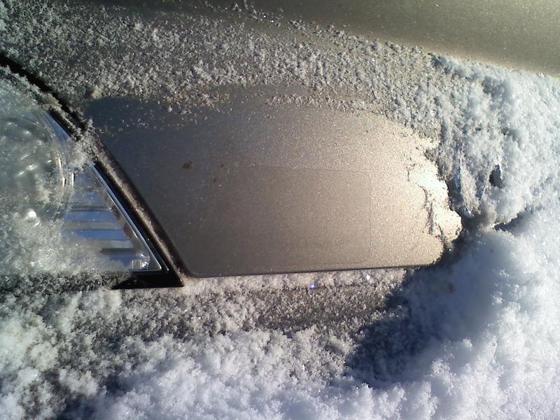

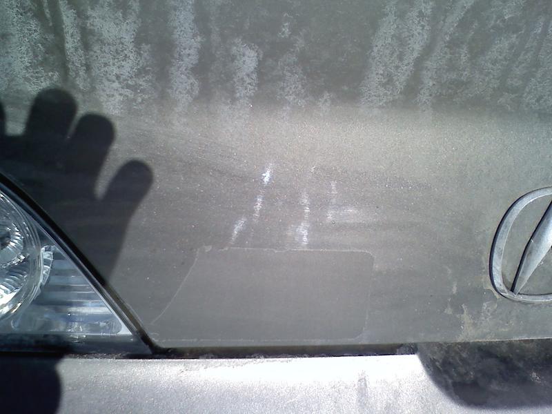

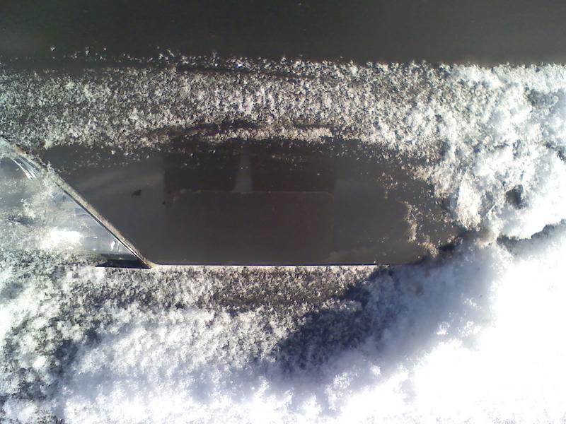

I dk how to upload my own photos lol But i tried

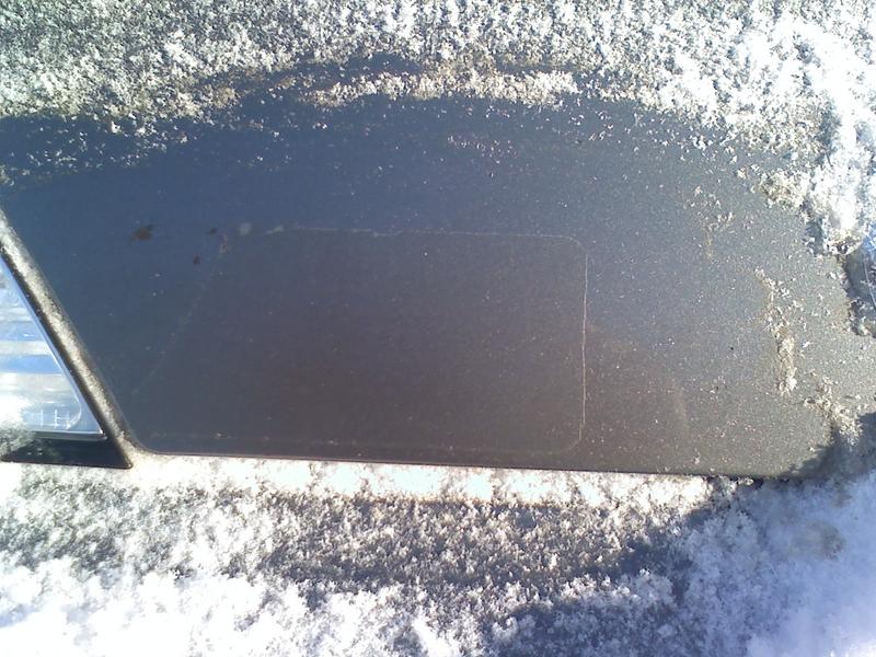

Sorry for the crappy pictures i took them with my phone. And it is hard to show up on a photo it does kinda look like there is just residue but it swear to you it is not

ouch that sucks why would someone do that? yeah the clear is gone for sure. the only way you can try to make it look a bit better is get some scratch-x and buff it alot until the edges start to blend in. but that spot will not be shiny anymore. you can wax it once youre done with scratch-x, but only way to really fix would be have the trunk repainted. sorry man. even if you mask off that area and spray a professional grade clear coat, you will still see the lines on the edges. or just find another sticker to cover over it.
this happened to one of my door moldings and i had to replace it. clear just started flaking off completely. and now the new one doesnt match the old one lol.
