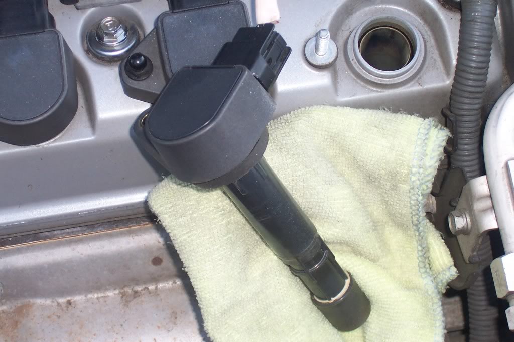

Hello everyone. Im wanting to do a tune up on my 2002 Honda Civic DX soon. Does anyone know if they make upgraded performance Ignition coils. I have a 1.7 liter 4 cl engine. Please help. Thank You

the stock coils are the best you can get and they work awesome.
