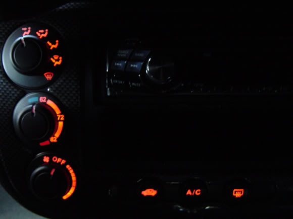

does anyone know where the fuse is on this or how can i fix this?...never done this before..thanks.

my car does the same thing i wasn't sure if it was suppose to look like that or if the lights were burned out. i have a VP 04.

if those two lights are out, i dont think its a fuse. if a fuse was out, i think all of them would not work but it looks like you still have one working.
my defrost light (the one you have on in the picture) went out one day when i was installing a stereo and it was out for a couple weeks. i gave it a good smack with my hand one night and it started working again and has been good ever since.
try giving it a good smack first to see if it helps, it did for me. otherwise you will have to remove your climate control unit to investigate more closely. you would do that the same way you would start installing a stereo. have you ever done that?

It's the bulb. 1 bulb lights both switches.

yea that would make sense. the recirculate air + a/c buttons use one light, and the defrost uses another light. i had the defrost light go out so only the defrost didnt work. it looks like its your other bulb. if they are regular bulbs and not leds, they are very easy to change and i found it at the local auto value store. i changed the one underneath my temperature gauge a few days ago and it took me less than 5 minutes.

so yeah i gave it a good smack and it went on lol...but when the light bulb goes off ill replace it....thanks.

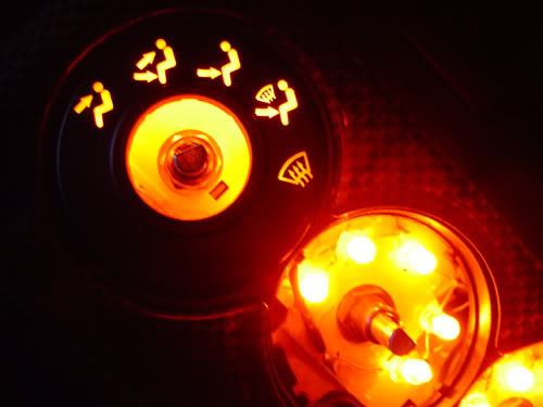

i just did custom leds, maybe cost $15 for the pack of 50 leds. i used 5 for each dial, and two for each button in orange (not amber). then used resistors to dim it down to a normal brightness and match the dials and buttons. there is quite alot of room inside the dials, but buttons you have to stuff them inside. ofcourse all the factory colored plastic films will need to be removed before you do any color changing with leds.

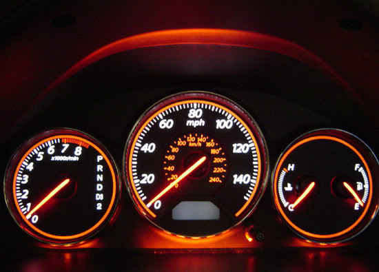

and put some led backlight for the gauges to match the orange color
