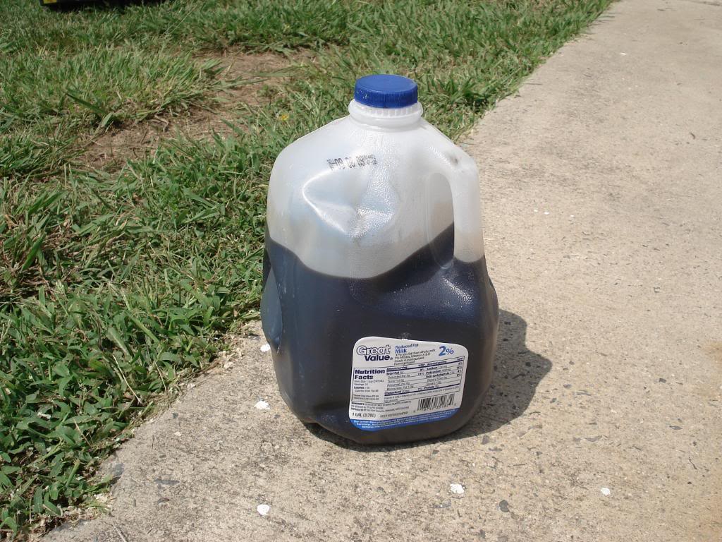

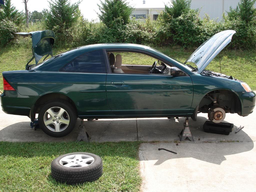

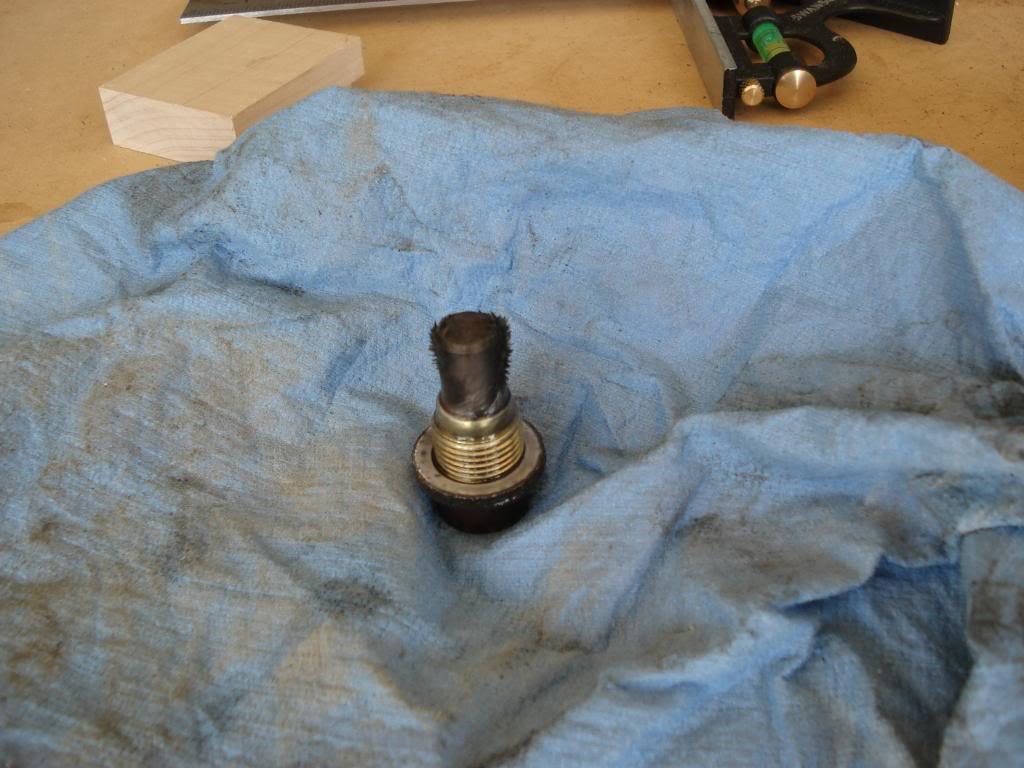

I just changed my tranny fluid the car and i gotta say the car shifts allot better! thanks alot guys
