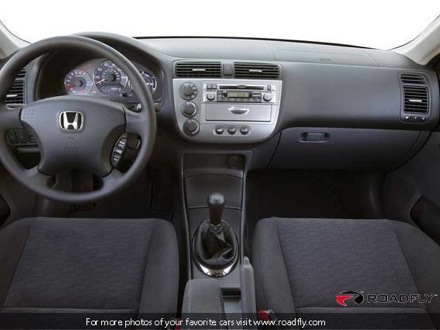

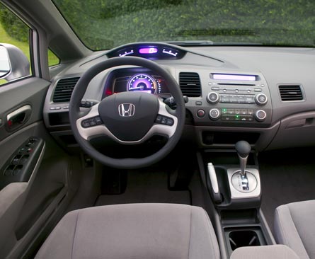

One thing for sure with the goal in this project and that is to make my car unique.
I am going to take the attached photos into photoshop and try to create how I plan on having the dash made. If anyone else wants to take a shot at it to show me your ideas that would be awesome as well!
Speedfoos has been helpful enough to get me the Circuit Diagram for the 8thgen but as far as being able to tell what all the pins on the back of the cluster would do I can not figure out too well. I am just starting my engineering major this year so I am winging all of this and getting help from a friend.
For the majority it seems like kinda simple, I am hoping that not much really changed between the two as far as Tach,Turn Signa, warning lights, ect goes. The only thing I can see needing done is a multiplier for the digital speedo because I know thats whats needed to make the s2000 cluster work(everything else on the s2000 hooks right up without anything else needed). I do think the 8th gen civics have a smaller tank? My google search came up with 13.2 and I think 7th gens are 14 so I might have to do some work on the signal going into the cluster to make it accurate.
Comments tho? Am I crazy? This is just going to be one of those little ongoing projects for me since I am studyin to be a Computer Engineer..I learn things a whole lot better when I am actually applyin them to things I like and since I really wanted the new civics because of the whole layout of the instruments then this seems like a great idea.
Also due to how much the radio section sticks out on a 8th gen, there really isn't a way to make that fit in my car so I only plan to have the instruments molded into my dash.(Wish I could do the steering wheel too but I am not going to mess with the airbag)

First things first... measure! If its small it will look funny, too large you better make it look nice as you could always make little plates so you dont see the edges...
If it fits just right then I guess it could look nice though I have my doubts.

The only problem I can see is that the 8th gen dash is way wider then 7th gen. May look kinda weird with them right on top of each other instead of off set. Best of luck if you can do it I think it will look sweet

Yeah I'm going to have to have the Speedo basically touching the windshield to try to keep the offset as large as possible.
