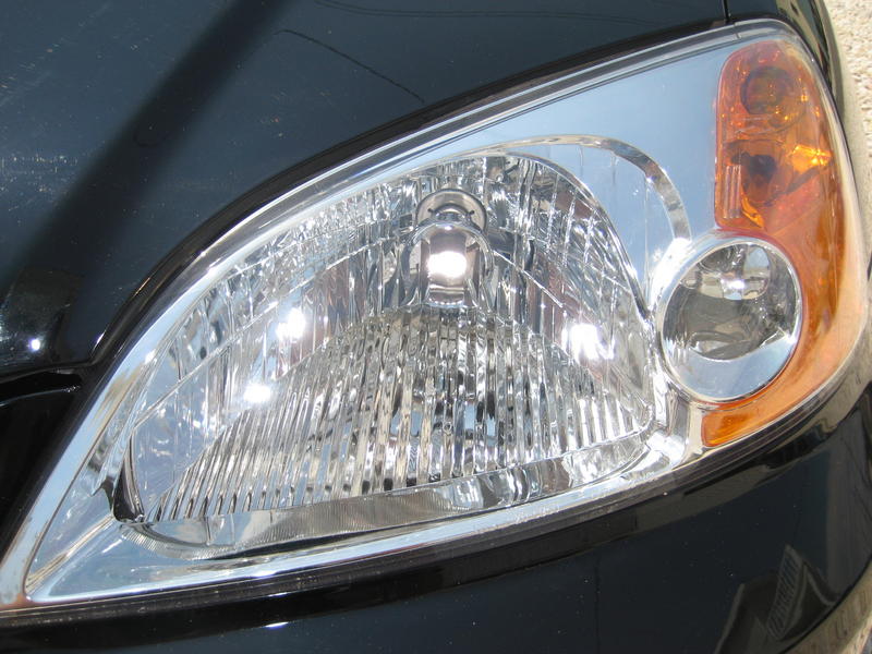

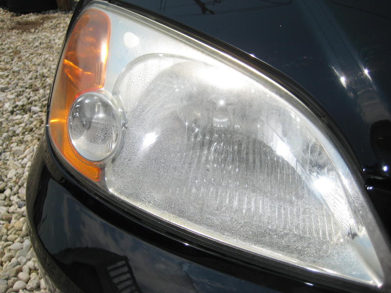

There's something wrong with my left head light....pictures below...anyway i can easily fix this?
first picture is my right headlight...
second picture is my left headlight...its not blurry thats the mist or fog or whatever it is inside of the headlight...

you can take it apart air it out/wipe it down and re-seal it

well thats quite alot of work. first figure out what it is. is it moisture inside the lens? try a hair dryer thru the bulb hole in the back to see if it goes away. if it does, you may have a leak in the seal and that would require removing and sealing the outside edges again. you have to take the bumper off, and the lights are bolted to the frame. you may be able to get away with drying them out and maybe the moisture doesnt come back. see if there are any obvious pokes or cracks that you notice on the housing.
