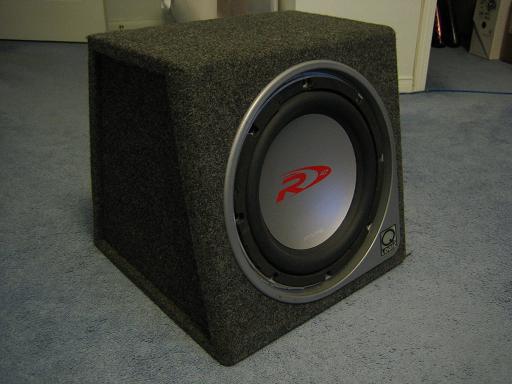

Just bought a 12inch Alpine Type R already enclosed. (SWR-1241D)
1.How much power should i push to it?
2.What type of amp would do the job?
I currently have infinty kappa's all the way around with my headunit doing 50x4. I just want a little more kick....the sub
The Link is specs on sub

get a 300 watt monoblock amp.i would recommend JL AUDIO.

how much are you looking to spend? the alpine PDX-1.600, or 1.1000 would be great on this sub. 1.600 can be had on ebay for like 200-250 brand new.

Look up how much RMS power the sub wants and match an amp to that. You are better off going with a name brand. No name amps may say 1000w and might be pushing 200. I've got a Alpine monoblock that pushes 2 memphis 12's in a sealed box. The bass is all I'll ever need, with the ability to make more if I feel like it. Check your head units RCA output. The higher the volts, the better sound you will have. I have an eclipse head unit and it seems to do pretty good.

I had the Type R (currently selling) and loved the sub, I had an alpine amp pushing 600x1 at 2 ohm with the gain turned down. Absolute perfect amp for the sub. The RMS is 500 so I would recommend having an amp that atleast pushed out 500 and turn the gain down. Reason being, more distortion if you max an amp out.
Look in the for sale section, I am currently selling my amp that I was using with the Type R. You can decided if that is the amp you want. I would highly recommend the same amp as I was using even if you dont get it from me (mines in the process of being sold but cash speaks ).

Whoops nevermind you have the 4 ohm sub. Your rms is 300. My amp would pound that thing lol. I would recommend a Alpine MRP-M450. You could use a more powerful amp if you turned the rms down. My amp could push two of your subs lol.

I'm running two Alpine Type R's on two Kicker zx300.1s and they do the job. The amps are around $300 new, but great quality. I think they're certified for 340watts rms or something like that.
The Type-R's are great though, I've had them for almost a year and had no issues what so ever. Just lots and lots of bass.
If you really want quality sound, you may want to start looking at a 4 channel amp and half decent speakers for the front and rear.. I ran two 12" type r subs, and they completely overpowered my 15wattsx4 rms deck, haha.
