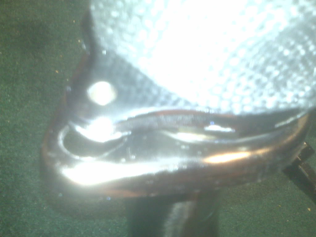

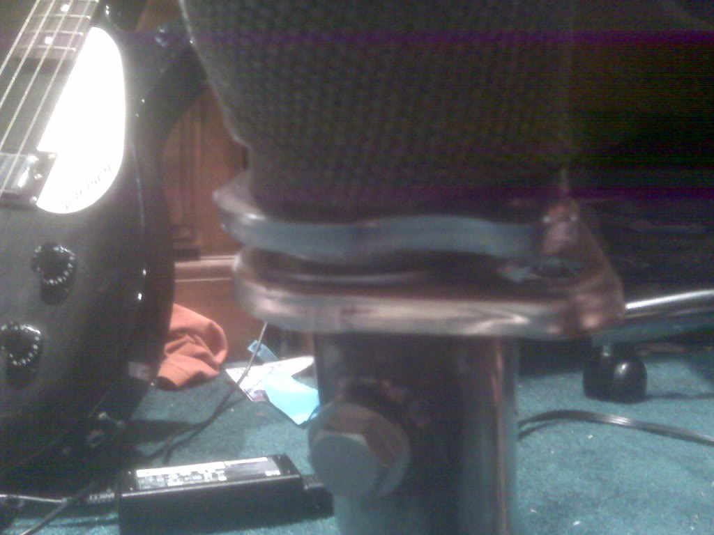

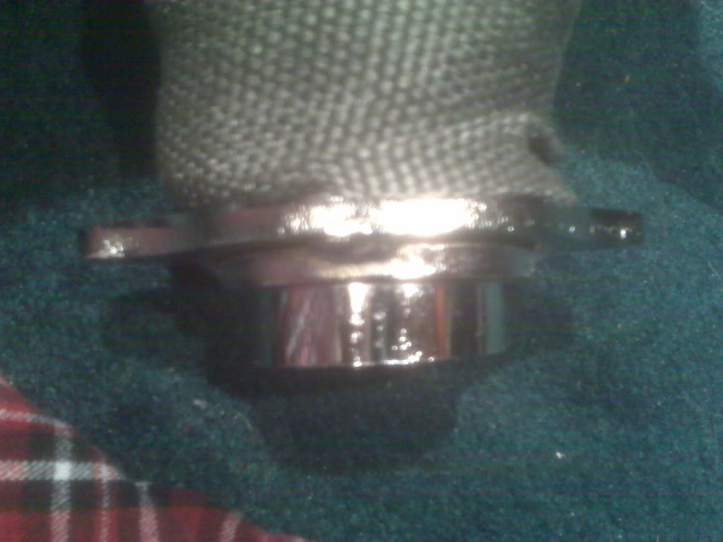

Hey guys, i've looked around some and just cant find anything on this. So here's the story, last year I bought some DNX headers from summit racing, they are for the D17a2 and they were on the clerance rack so picked those up and really havent done anything with them except heat wrapped them over the winter as I was waiting for everything to warm up before I started working on the car. So I just ordered a downpipe and opened it up. So, as you can see in the pictures the header has a flat bottom (like the tube) and the downpipe almost has a little funnel, it doesnt like fit together right. The header will wiggle around and not sit flat into the downpipe. I thought this was all wrong and got all mad and looked around at buying header/downpipe combo's, just so I'd know they'd fit, and looking at pictures they all look to be this way (from what i've seen, with the funnel shape on the downpipe but a flat bottomed header) So basically is this supposed to be this way? Or am i screwed, go spend 300$ on a combo? thanks for the imput!

lol dude you need to buy a donut gaskit bring it to napa so you can figure out the size you need there like 5 bucks problem solved. and header wrap is not a good idea they trap heat and cook the metal well obove recommendation by the manufacturer making the metal brittle over time they also trap moisture that will cause premature rusting and also absorb oil which can cause a fire ditch that and get thermo-tec heat jackets they do none of the obove and allow the metal to properly expand there also easier to put on and off its so much better.here is a pic of the gaskit and header jackits.
