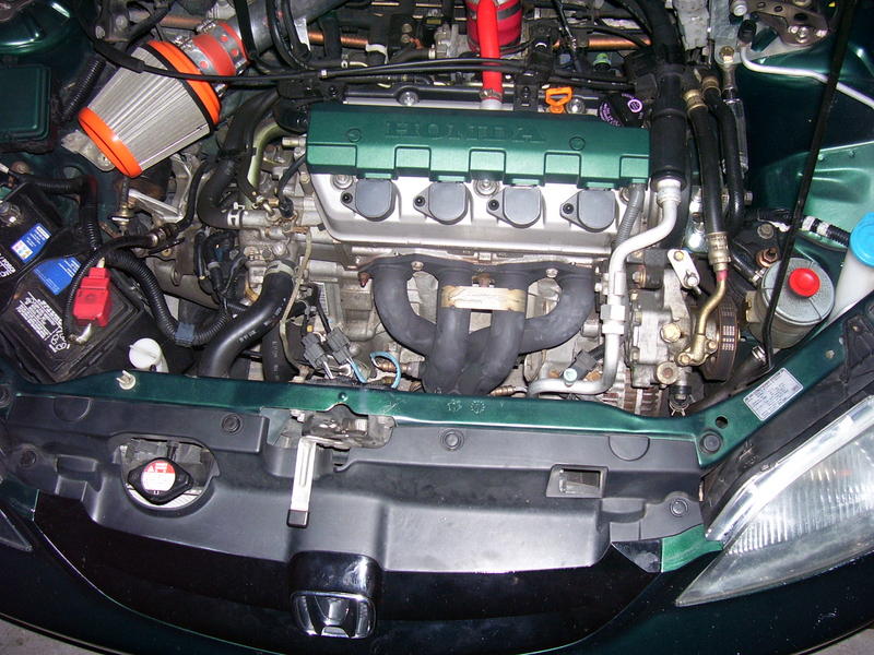

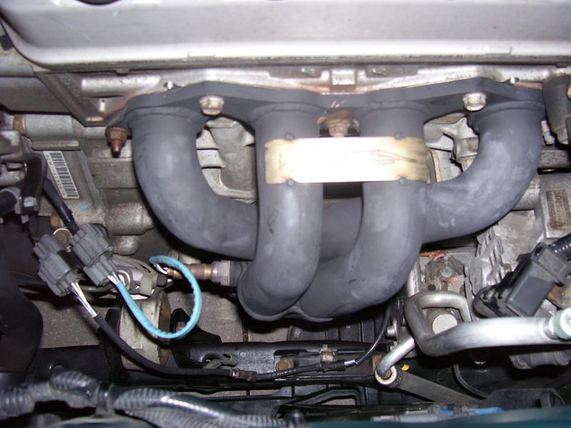

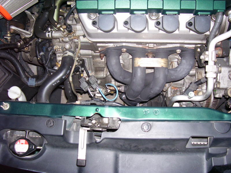

heres some pics, found out that camera has a nighttime setting.... anyway, enjoy all u pic requesters out there

god those things are ugly lmao. yea man u removed ur resonator and put a str8 pipe of course its gona get loud.. plus no cat.. if im getting this right. throw in a universal resonator from magnaflow..theyre nice. and...i duno wat else lol..
