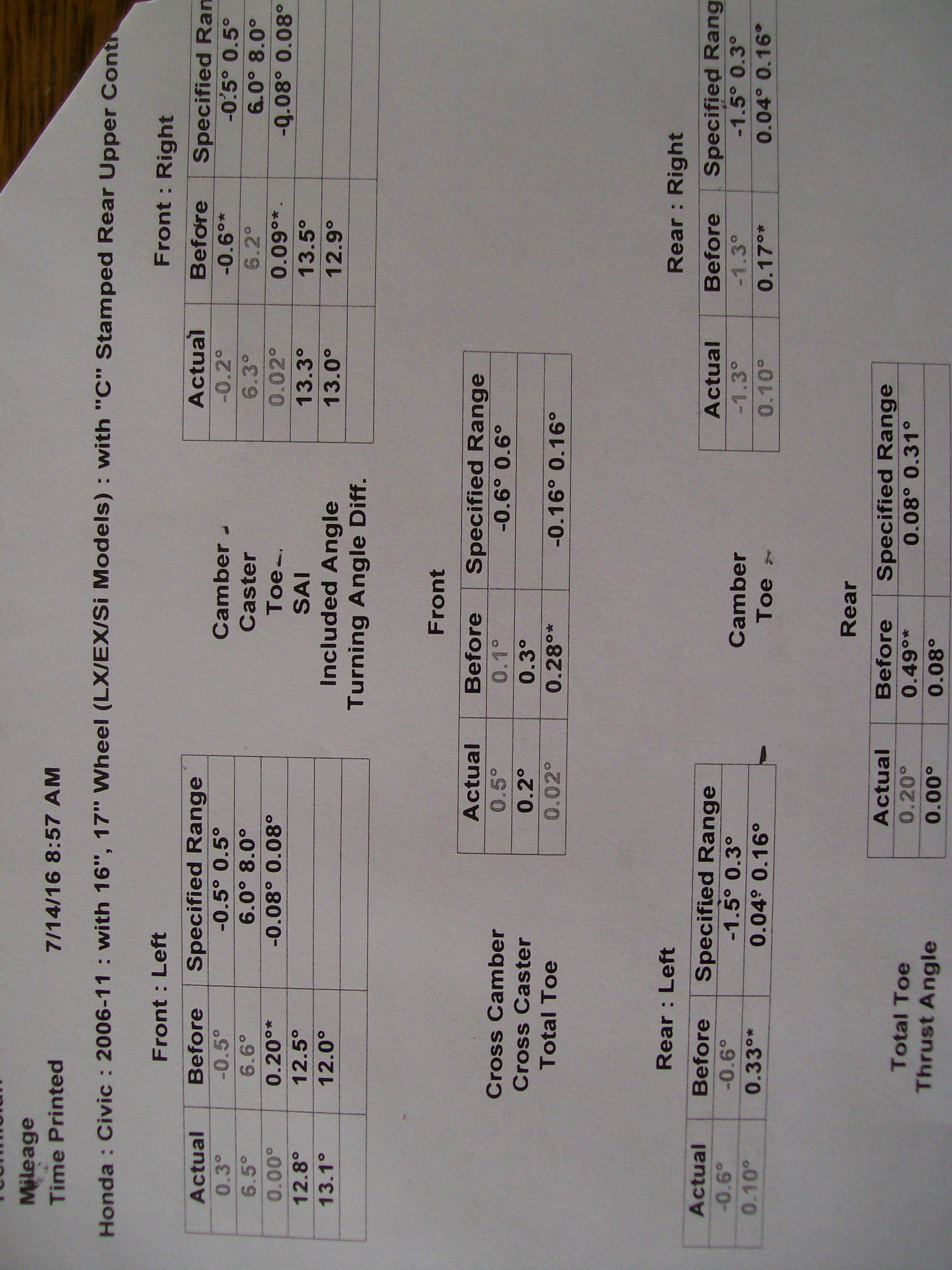

I'm out of my element with alignment. Yes, I put on new Michelin tires and had a 4-wheel alignment done. The alignment print out has Actual/Before/Specified Range readings. Which are you asking about, before and actual?

Yes. Post a picture of the printout?
Curious to see how far the alignment was off after the engine work was done, if it was significant or not.
(Keep in mind someone who knows what they are doing can manipulate the numbers.)
And to see the numbers for the rear which would have not been touched during the engine work.

I took a picture but can't figure how to post it? I saved to my hard drive. sorry, duh.
I use an image hosting service like tinypic or imigur. Upload the pic there then post the link (URL) to it here, using the 'insert image' icon above the text reply box.
Or...From the FAQ: https://www.civicforums.com/forums/f...b3_attachments

Thanks. I think I attached a jpg file of the picture but don't see the icon.

I see a bunch of toe-in that isn't explained by the engine job (rear is excessive as well as the front).
Toe-IN can cause wear of the outside shoulders of the tires.
I see someone went to a lot of trouble to change the camber on both front wheels. Did they mention doing this, or needing hardware (special bolts) to make this change?
Possible previous alignment job errors?
Wear and tear, winter, potholes, curb, etc.?
Old Jul 18, 2016
