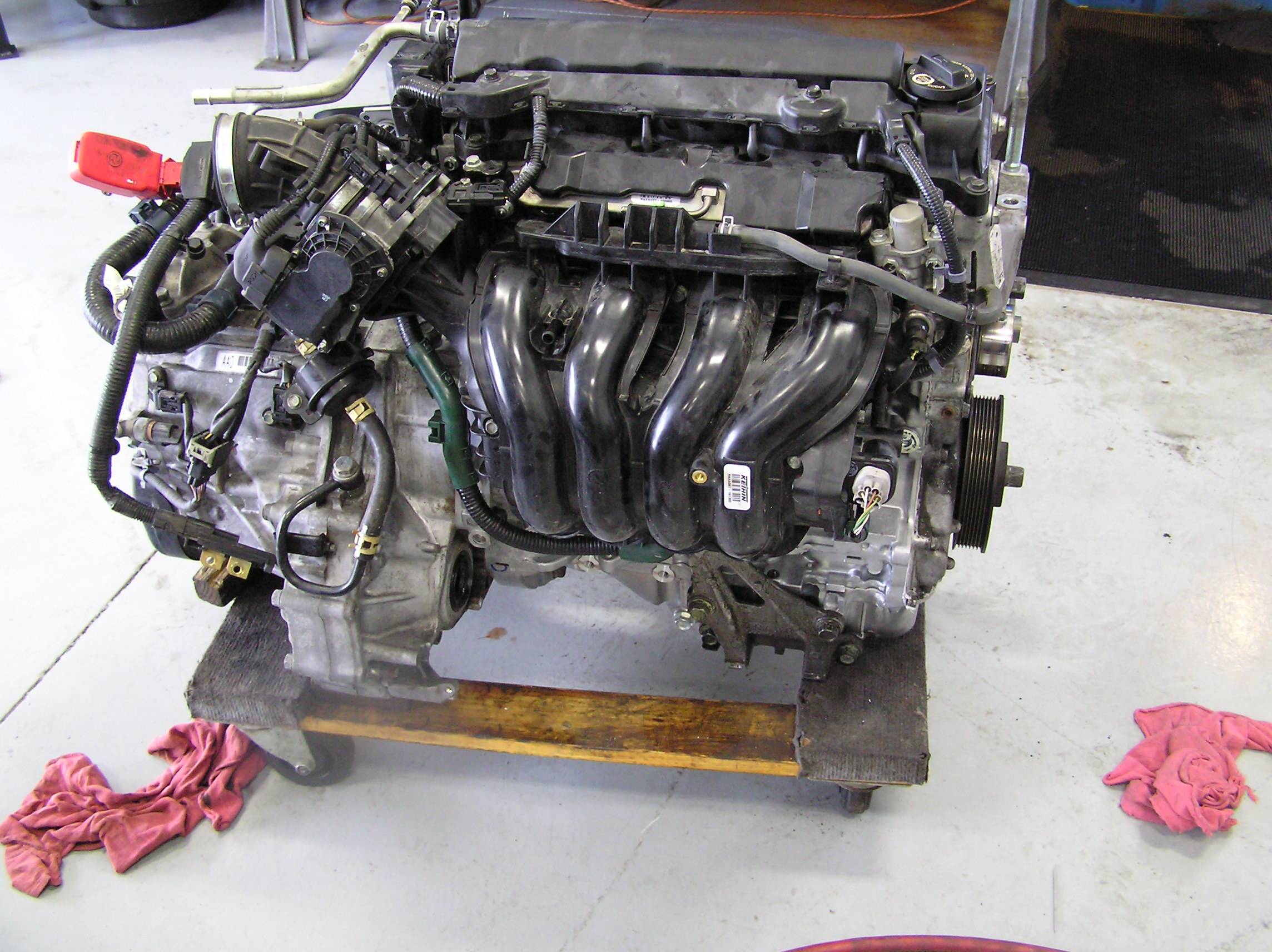

Somewhat handy pic of an R18 engine and trans out of a 06-09 car, 12 is similar:
You can see the trans filter (round can below throttle body) on the back of the trans

Thanks guys for the info. No wonder I couldn't see it there under the throttle body. I was under the impression that the 2012 automatics were not cvt. Mine has pretty firm shifts. The cvt's I have driven were all real slush boxes and the only way I could detect a shift was by watching the tach. Please correct me if I am wrong.
12 Civic has a normal automatic trans, unless you drive a hybrid.
