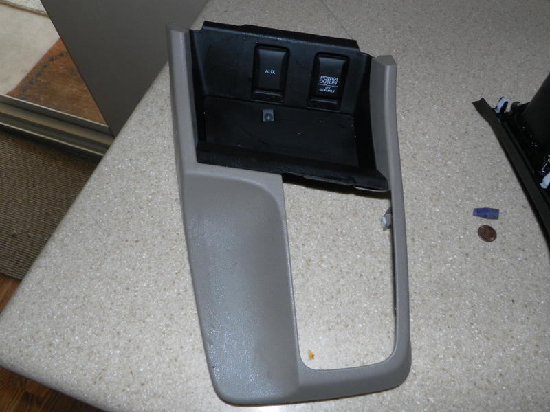

You motivated me to make a greater effort. Got #9 off. The cup holder doesn't come out without #9. You have to remove 4 screws from the bottom to just get the cup holder.
What I did was I got a plastic scraper and pryed up the bottom shifter plastic cover. The piece popped up. Then I pryed up #9 starting closest to the shifter, then it comes off. No screws to worry about. Make sure your arm rest is open, not down.
Sorry about my horrible directions. If have a question, just ask.
