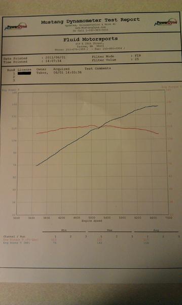

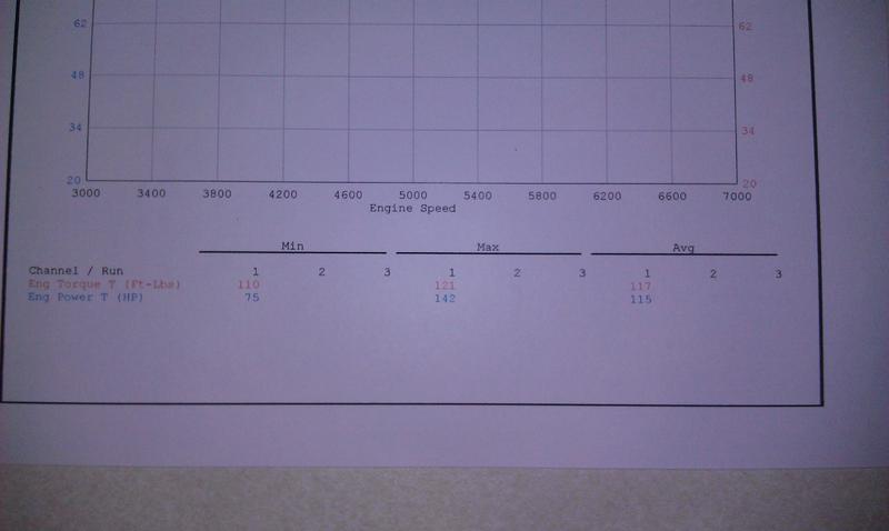

Ok, Today's Dyno run didn't put the numbers that i wanted to start with, even did two pulls with a +1WHP gain on second run. 142WHP 121TQ. I have the K&N 69 Series Typhoon CAI installed with the C&C Cat Back Exhaust. The Turbo kit "Should" be here by this Friday, so I'll put hopes up for Saturday as installation day and Monday as Tune Day. Goal is going to be 230WHP.

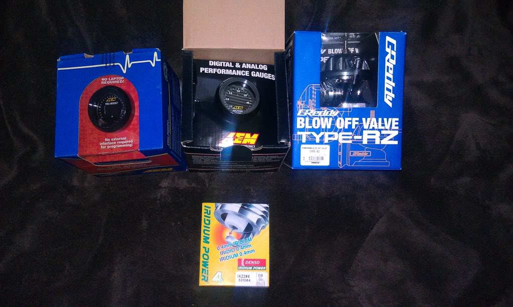

Parts Rolling in.... AEM UEGO Wideband, AEM Tru-Boost, Greddy type RZ BOV, Denso Iridium plugs.

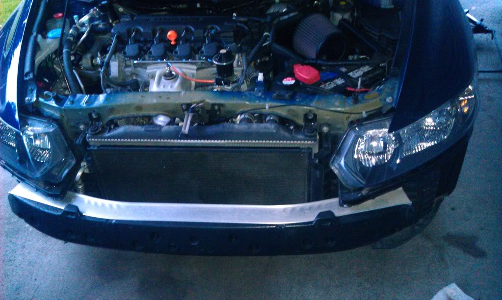

Turbo Kit is in, front bumper is off, reservations for shop time start at 1000 tomorrow!! Looking forward to showing the full installation. Check out the DYI I did on the front bumper this afternoon and let me know if I need to be more specific on instruction.
