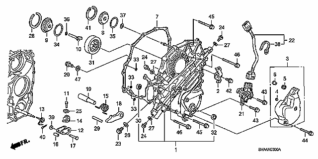

I'm fairly certain the part being referred to is either 3 or 5.

But isn't the left side the drivers side? Looking at the diagram in your link it has an arrow pointing to the front. And the items in the diagram, parking pawl, parking brake, shaft fork, etc I am thinking that is the drivers side of the engine and that is a cover for the trans?

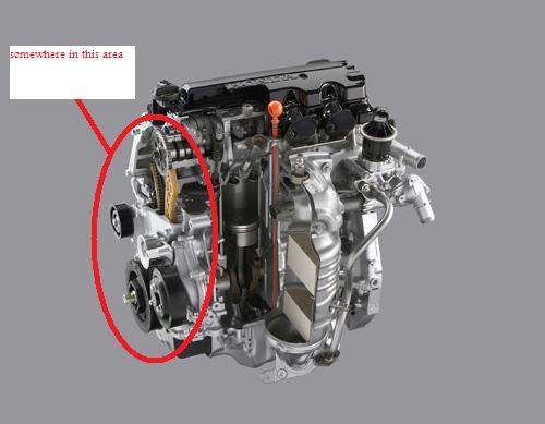

Maybe my description wasn't that good. Here is a picture to try and help.

Front Inspection plate is located directly above the Power Steering Pump. Black Cover approx. 5"L X 3"H with Three Bolts (10mm) securing it to the timing cover. The reason for the Three hour Charge is due to the Drive Belt must be removed to access it. To be more accurate the Job for and experienced mech. should take no longer then 1.5 hrs.. But the dealer compensates for any unforeseen headaches they may run into in their billable hours prior to any service. And yes, they are known to leak under heavy driving (Heavy Foot Driving). I would not recommend RTV sealant due to the heat but any high heat "copper base" would work great. The dealer sells a number of products that can be used. Hope this helps
The Black Cover in the Pic below is the inspection plate. Picture was taken from inside the passenger wheel well.
