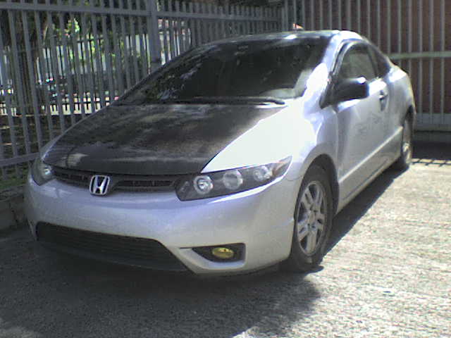

Hi guys, my situation is the following;
I install a radio system to my 2007 honda civic DX, after installing at 1st I had dimmining lights, I bought a yellow battery and a capacitor and replace the radio with another upgrade version of what I had previosly bougth. This stop the dimming light most of it (before also the system would shut down completly when a certain volume would be reach) and the shut down of the system has stop most of it. It still turns off at times just like before when it reaches a certain point. Now the altenator issue I was playing music and the battery light came up this has happend 2 times already, taking into cosidaration the shut down issue and the battery light turning on leads me to think the altenator may be going bad. So Im guessing the system is "asking" for too much power and it turns off when is not there also pushing the stock altenator to its "max". Is there a way for me to determine if this is what's really happening? and how do I choose a "better" altenator to my needs?
I have install the following items;
Tsunami Hybrid Capacitor 40.0 Farad with Lcd Meter
MTX JackHammer JH404 4-channel car amplifier -- 50 watts x 4 at 4 ohms (running 8 six inch speakers @ 2ohm)
MTX JackHammer JH600 Mono subwoofer amplifier -- 600 (running 2 ten inch @ 4ohm)
Kenwood KDC-MP442U (receiver unit)
Also the above receiver I not only have the RCA plug to the amps but also thru the wire harness I have the factory speakers connected too.
Thanks in advance
JR
