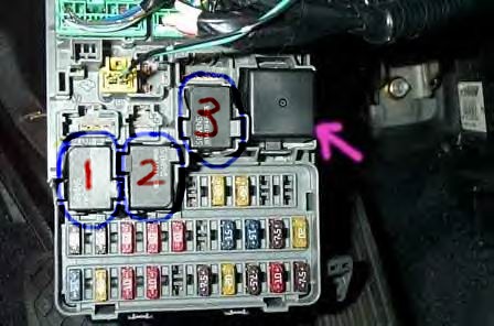

anyone know which one is blinker, 1, 2, or 3. wanna make sure I pull the right one~
I want to change the stock one to 6x flasher one, also does it will damage to the electrical system like relay..etc.

The blinkers is the on with the arrow pointing at it. I have it done to my car and it does not damage anyhting.

It's easy to find out which on it is. Just turn on your flashers and listen for the one that is clicking. That will be your turn signal

We just told you which one it is moron. The one with the pink arrow. And if you still aren't sure then listen for the clicking box damnit.

the one with the pink arrow. it's pretty hard to miss
