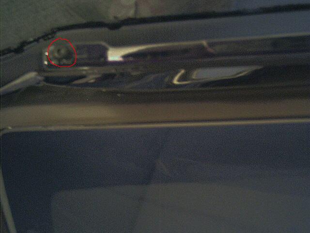

I just ran into the same prblem on my 03 EX
Old May 26, 2003
Diablo's Avatar
Posts: 585
From: Milwaukee,WI
Diablo is an unknown quantity at this point
my camara is kinda shity so i hope you could see what screw he is talking about. by the way a visegrip worked just fine.
