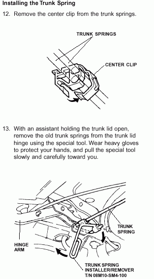

does anyone know an easy way to remove the trunk springs without breaking anything on a 03 coupe so I can attach the stronger ones that came with my new oem spoiler?

You can buy a trunk spring removal tool from HandA-Accessories.com. It's like $4.91 plus shipping.

here's an excerpt from the coupe spoiler installation instructions on removing the stock springs...
